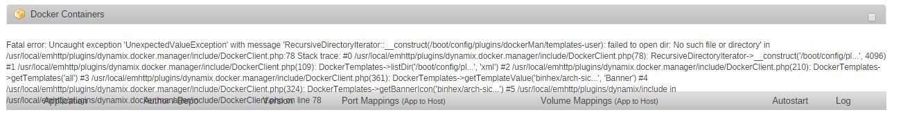

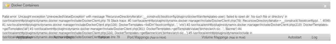

I have had continuing issues with my flash drive becoming corrupted and have no idea what is causing it.  Before the upgrade to 6.1.2 the flash drive would show an error and the mover would move the appdate fold to the array, and if I rebooted the server it would show and invalid parity, and I would have to run check disk on a windows computer.  Now that I am on 6.1.2 it did not move the appdata folder but on the dashboard it doesn't show the dockers I am using(Sickbeard and Sabnzb) and in the docker tab I get error messages, I have attached a screen shot of that.  Also a week ago I replaced the flash dive thinking that was the issue, and that has had no effect.  I am not very experienced in this so any help would be greatly appreciated.  I am also attaching a section of the syslog that look like the problem.  Again thank you for any help.
