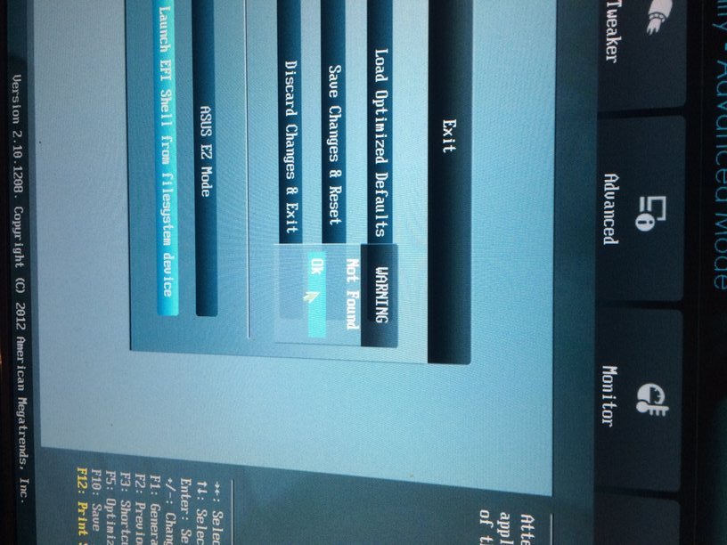

When I go to use the uefi shell from bios (Its a Asus board) it simply comes up with not found.

what's a model of the board?
a attach a screenshot please.
Motherboard is Asus B75M-A.
I am in the process of updating the bios.
This is what was coming up when I try to use uefi shell.

according to manual:
"This option allows you to attempt to launch the EFI Shell application (shellx64.efi) from one of the available devices that have a filesystem."
so i believe, you must have this "shellx64.efi" file on one of you attached drives..

I ended up creating a bootable uefi windows usb then got the full shell and trial and error ended up finding out what folder it goes in.
End result is I got into uefi shell.  Had a play around in there and got unknown commands so will play around with it some more tomorrow.
