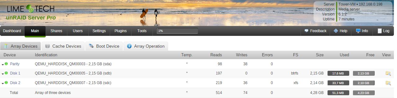

This is possible, I have one KVM unraid VM that use one of my 2 USB sticks for the pro licence, I boot with both these USB:s connected , but I "hide" the USB that my VM use in syslinux.cfg with pci-stub.ids, without that it will not work.
My VM boots from an .vhd image file and use the USB for the licencing.
