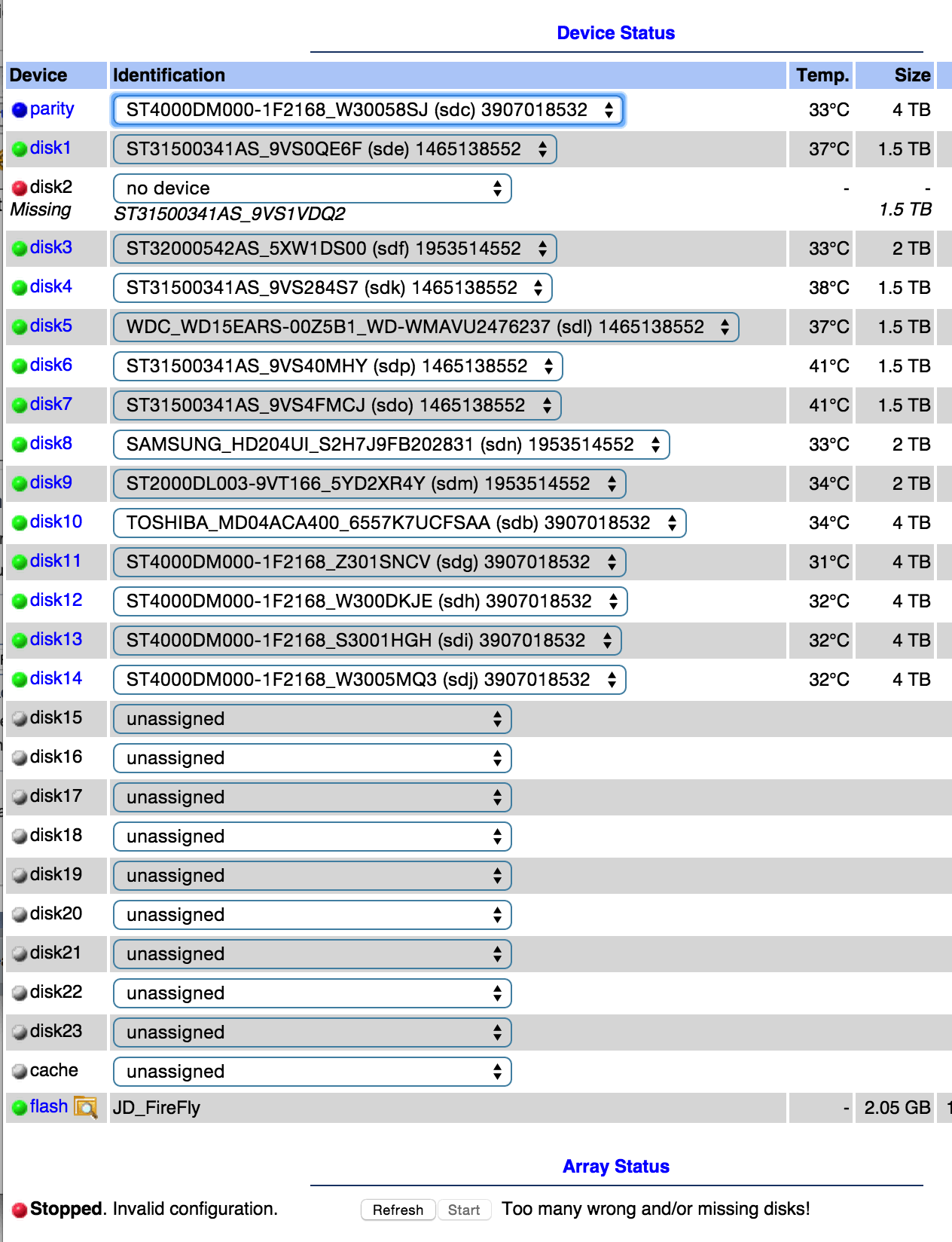

Parity has no filesystem so "unformatted" is meaningless for parity, as is reiserfsck. Post a screenshot.
Screenshot and super.dat attached
super.dat.zip
I replaced the supposed bad drive but still will not allow a start.  Message is "Too many wrong and/or missing disks!" but only disk 2 is wrong as I just replaced it with a spare.  Parity is still blue.
Blue indicates a new disk. Disk 2 cannot be rebuilt unless all of the other disks are green. Was parity installed previously? Reinstall the original disk 2 and post its SMART report.

At this point a rebuild isn't an option -- and as noted above you can't "rebuild" parity.  Your only option is to replace the failed disk #2 and restore its data from your backups.    Your parity drive may also be bad -- I'd look at the SMART data and, if it shows any issues, replace the drive.
There IS a chance that the drive #2 issue is a failed controller and/or a cable that needs to be reseated ... but I suspect it's more likely the drive has simply failed.

How do I get the array to come back online given it still says  "Too many wrong and/or missing disks!"  I've tried putting a new disk and saying "no disk" on my bad/missing disk but still does not give me the option to start things up so I can create a new parity and format that new disk.

... How do I get the array to come back online given it still says  "Too many wrong and/or missing disks!"
Just do a New Config (on the Utils tab).

Thanks guys.. I'm up (without disk2) and parity is rebuilding.. I'll see if I can get Disk 2 up on another machine..
