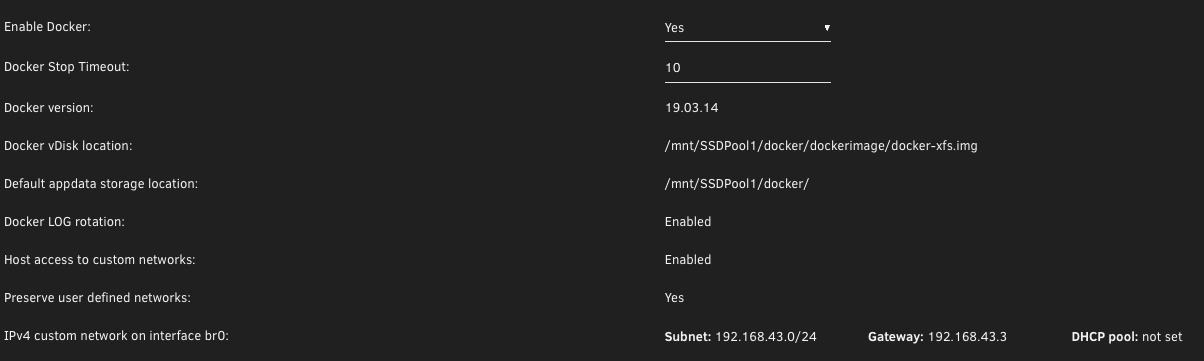

Nope, for me still whole system lockup when having the docker.img on my zfs array on 2.0.4/6.9.1
Now that is strange.  I have docker.img in it's own dataset on a raidz1.  My settings

Ok, i can only spot a few differences between the settings of my dataset and yours. Like the snapdir is visible on my end, createtxg is 1 instead of 14165, xattr is set to on instead of sa. Other then that, its basically the same.
But there are still a few differences on your end compared to mine like i am running RaidZ2 instead of Z1 and my docker.img is not on a separate dataset but rather just simply on a combined dataset for basically everything. and well other then the jdownloader, nextcloud and mariadb i have no container in common with you.
@MarshalleqCould you tell us a bit about your configration and the settings of your dataset? Maybe that could help
I think we can omit createtxg as it's described as "The birthtime transaction group (TXG) of the object."
Hey thanks so much for your help Arragon, this is great!  So if Joly0 has those 3 dockers in common, of those I have nextcloud and mariadb.  There are plenty of others that I have in common with Arragon though, but I'll leave them out as they seem to be irrelevant.  Also, I have a test box that has unraid but is basically only used for encoding so has nothing in common with what either of you have listed in regards to dockers used, so I will upgrade it all to latest shortly and see if it's impacted.  As far as ZFS setups, on my test box I have:

Both of these boxes have exhibited the issue.
Both systems have docker.img on mirrored zfs shared with active docker configs.
One thing I don't see listed above is fstrim, which I do have enabled on all my ssd's. I also have xattr set to sa and I am using the new compression type zstd-1.
I have attached output of zpool get all and one zfs get all from one snapshot
Also screenshot of my docker settings below:  What is your host access to custom networks set to?  That's something else I've enabled from default.
988906850_ScreenShot2021-03-13at9_27_30AM.thumb.png.f2eadd600192b3d826a32b59739523d0.pngZpoolGetAll.rtf ZFSGetAll.rtf
Edited by Marshalleq
Thanks for the information.
In the next few days i am going to make some more precise tests to see exactly which containers are affected by this issue.
I think nothing from zpool get all  seems to cause that issue, we have mostly the same settings and the ones we dont have cancel each other out or are irrelevant such as the createtxg or the snapdir option.
Also it seems not to make a difference having Z1 or Z2, but we will see, jsut lets try to pin down this issue as precisely as possible.
Edited by Joly0
There was some time ago, issue with something on custom docker networks, should probably disable that and check.  I've updated my test system now and it 'seems' to be OK with latest ZFS and latest unraid.  If it is, I will try adding those few docker containers in common and see if there's an impact.
