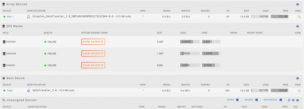

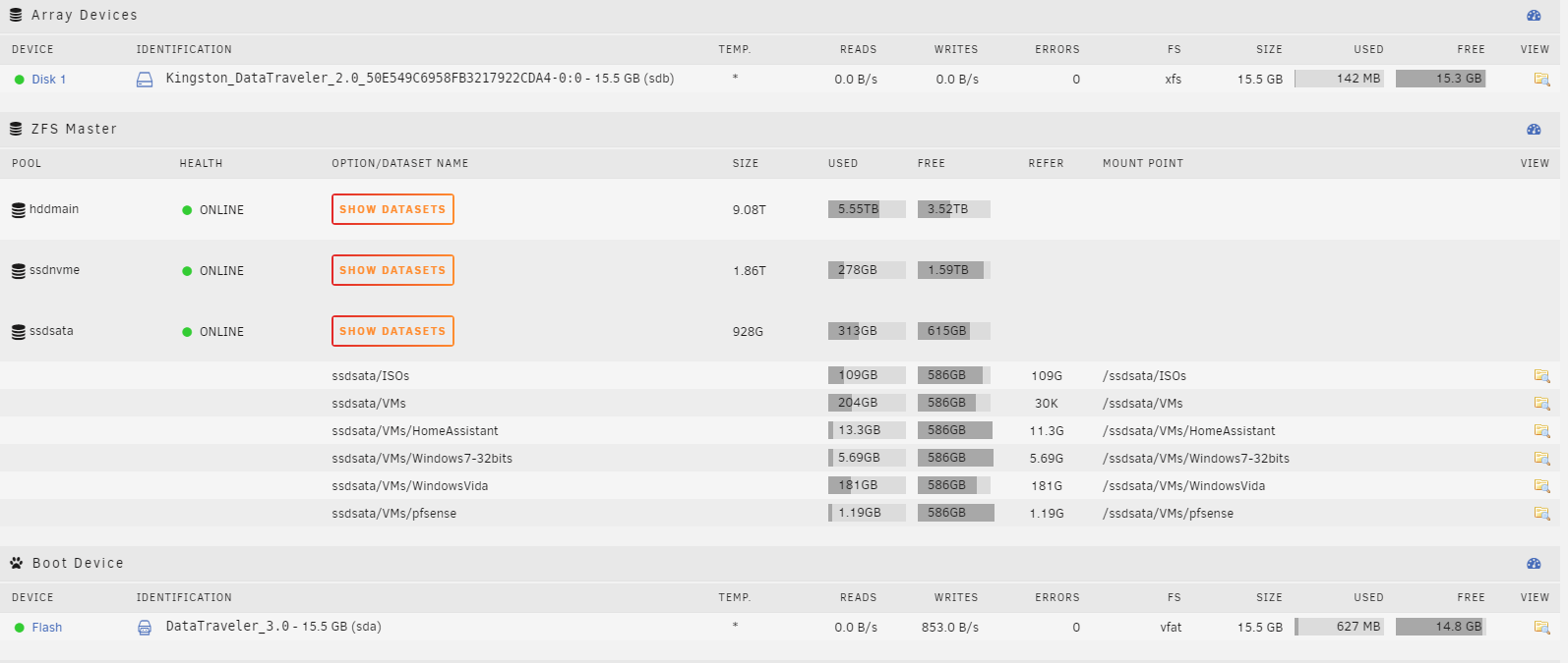

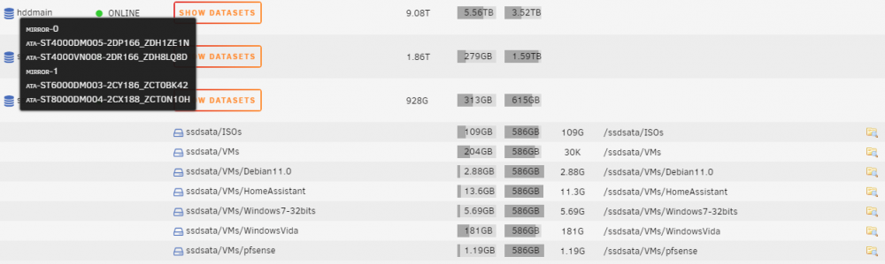

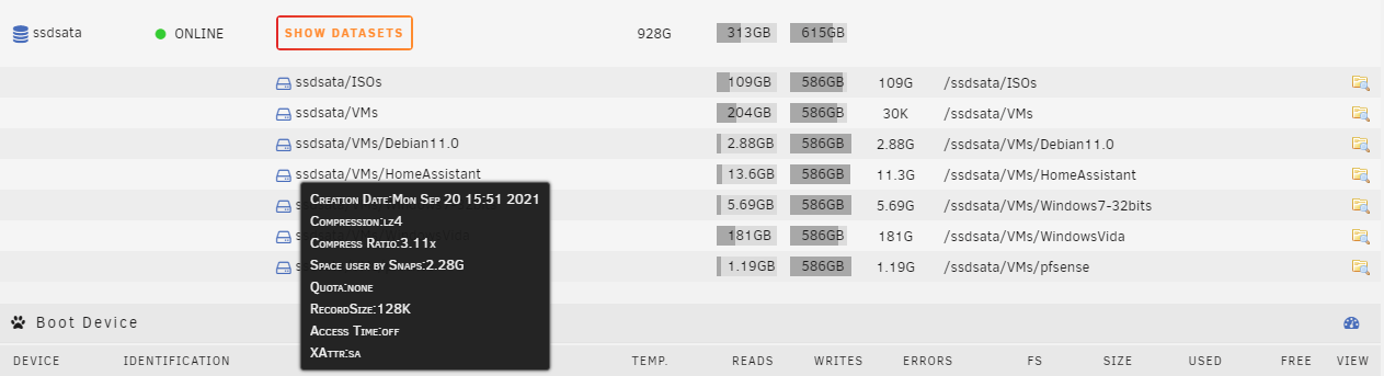

I have been working in a ZFS Plugin for the Unraid Main Tab, considering that I am not an experienced PHP developer,  this probably is going to take a while. However, I want to ask you ZFS users, which information do you want to check in the Main tab, considering that as today we don't have any information about the pools.
Any comment or feedback appreciated, this is the current look:
Edited by Iker
Please keep in mind that ZFS will be added to unRAID in 6.11 if the poll stays like it is now, see here:
wow super !
90% done
i would vote for:
.. last snapshot date
.. what device is in this pool
 True, but we don't know when is going to be, probably next year, in the meanwhile I'm not planning replace the Unraid interface, just add some visibility.
8 hours ago, Dtrain said:
i would vote for:
Devices in the pool  👌
Last snapshot date… It's completely possible, but please hang in there for a while. Snapshots in general are a different monster, I'm thinking how to display them, there are some systems (like my own) with 1K snapshots in a single pool, displaying or even list every single one could be difficult.
Nice job, looks great!
Live read/writes stats for pools?  ie. 'zpool iostat 3' ?
Perhaps make the pool "green ball" turn another colour if a pool hasn't been scrubbed in >35 days (presumably it turns red if degraded?)  Maybe a similar traffic light indicator for datasets that don't have a recent snapshot?  This might really help someone who has added a dataset but forgotten to configure snapshots for it.
Maybe make the datasets clickable - like the devices in a normal array?  You could then display various properties of the datasets (zfs get all pool/dataset - though maybe not all of these) as well as snapshots.  Some of the more useful properties for a dataset:
used
available
referenced
compression
compressratio
I'l take a look at this.
Green ball turns yellow if degraded, red if faulted, blue if Offline, grey otherwise (Unavailable or Removed); the scrubb info is already present in ZFS Companion, i don't have the intention to replicate the information already present.
Great Idea!.
used
available
referenced
compression
compressratio
Got that info, nice & clean (I think), working now on snapshots, just the basic info & date:
haven't forgotten you (dtrain):
Wow, looking forward to getting my hands on this!  Fantastic idea, and nice job!
