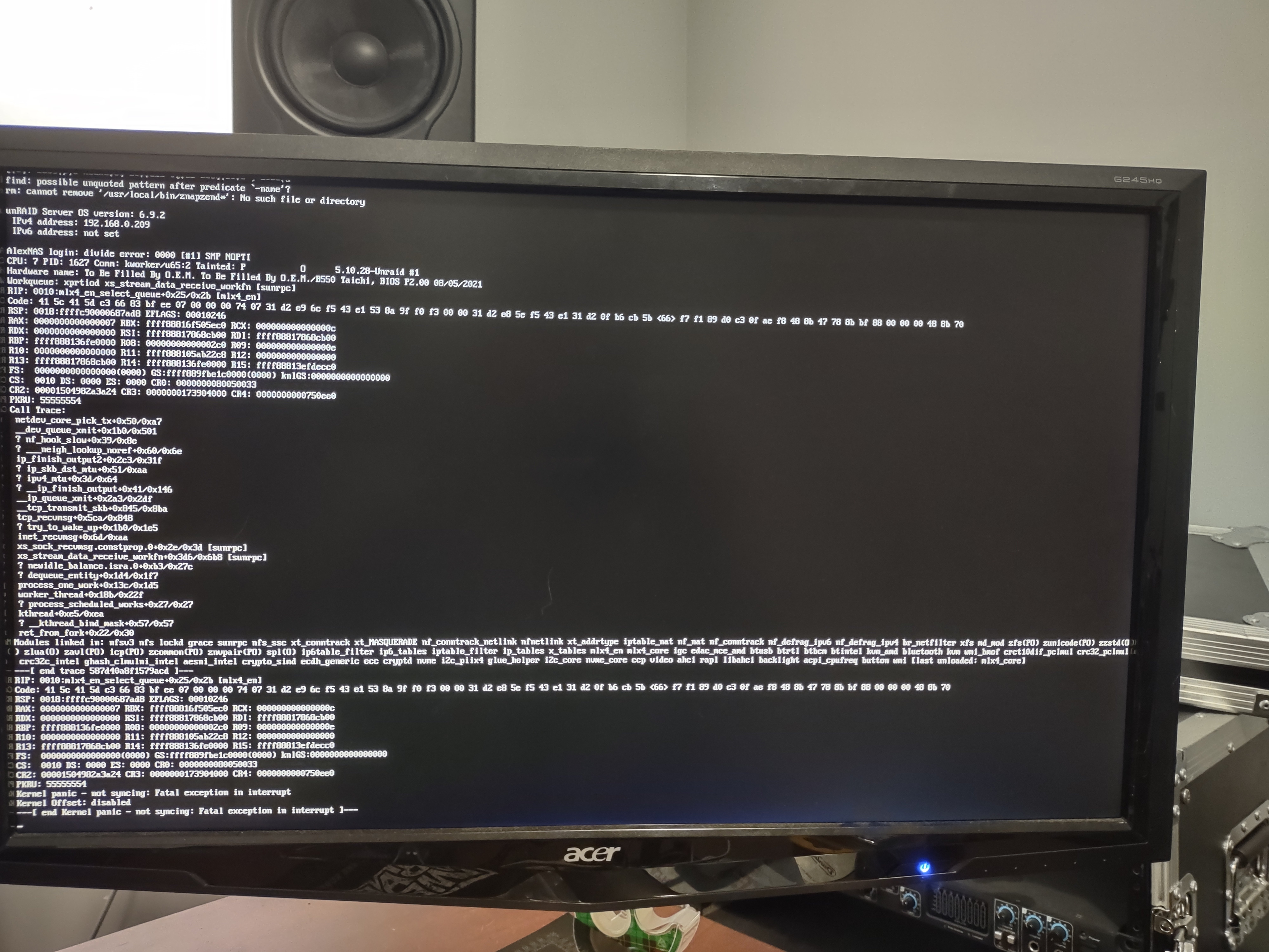

Hey all,
I'm getting kernel panics when trying to transfer over large volumes of data via rsync from my backup to my ZFS Unraid server.  I'm amazed at the sheer speed of the transfer from spinning rust, but it crashes.  IDK what's going on.  I have diagnostic information if that helps, or if there's something else you guys need, let me know.  Figured cause the issue is with ZFS, this is the place to ask for help.  Anybody know what to do?  I saw a year and a half back someone had a similar issue.  Also had to rebuild everything from scratch before cause of this issue--thank goodness for backups, seriously.
I'm on 6.9.2, BTW.
Edit: I can't get a good syslog of the issue because it wipes itself when I have to hard reset the server, so I had to take a photo of what my screen is telling me.  This was during an rsync of data from the backup server via FTP share to the tank.
alexnas-diagnostics-20211031-1717.zip alexnas-syslog-20211031-2118.zip
Edited by asopala
Added log, best I could

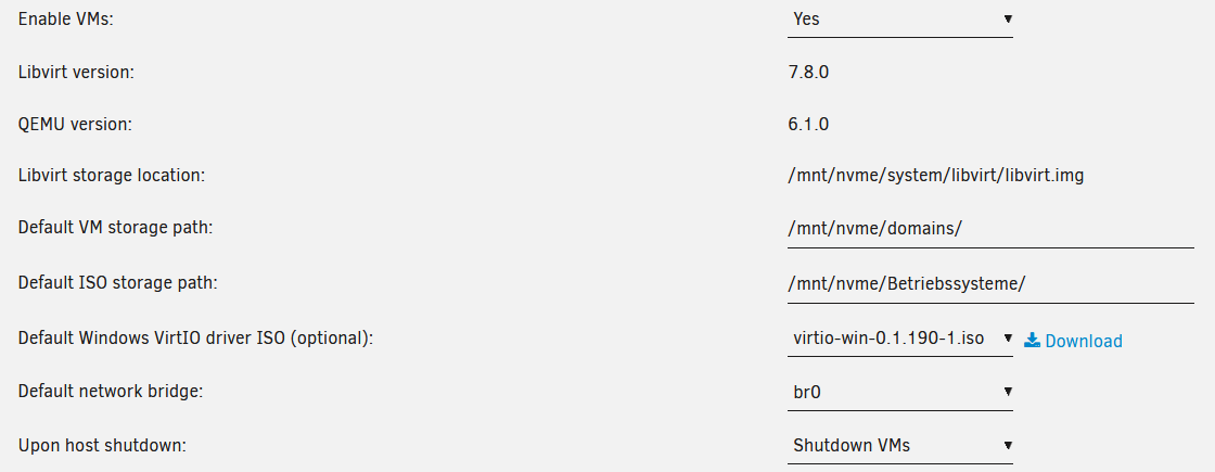

On 10/31/2021 at 1:48 PM, chronocide said:
However, now that I've found the correct settings, it seems Unraid will not let me place the VM ISO or image directories outside my primary array (which again is just a thumb drive I'm hoping to keep nothing of importance on).
Do I need to soft-link from inside /mnt/user into /mnt/zfs1 (the name of my pool)?  How can I store VMs and ISOs in my ZFS dataset?
Regarding the question of whether or not Unraid can be run without an Array - as others have already pointed out, the answer is no. However, earlier posts in this thread point out that you can run your array off of a single USB thumb drive if you so choose.  I am pursuing this strategy now.
Having said that, I am dealing with an issue where the Unraid UI will not let me configure the location for my VMs and ISOs to be anywhere outside of the array.  As you might imagine, I do not want to run my VMs off a thumb drive.  If anyone can provide some insight as to how I might set my configuration to store VMs and ISOs in a ZFS dataset, I would appreciate the help!
I can type anything in on VM settings and set the storage location no problems (make sure to include the trailing slash)
I also can type whatever I want in there and even have set the libvirt.img to be on a ZFS Pool:
Thanks @ich777 - please disregard my previous message. It must have been some kind of user error.  I had thought that it wasn't allowing me to manually set the path, but I saw your post and decided to simply try again and sure enough, this time it worked.
No idea what I had done wrong last time, but I was previously seeing red text highlighting the two paths for VM storage path and ISO storage path, preventing me from saving the config change.  Perhaps I simply mistyped the directory names? Irrelevant now....
thanks again
