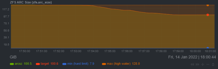

1 hour ago, Marshalleq said:
I thoroughly tested the memory usage before and after for the Raidz1 array as I was unsure if all or some of it would go to the special vdev.  I noticed no difference at all.  I did the same for the virtual machines on the array without the special vdev and while this was less scientific, also noticed no perceptible difference (I mention because so many people cry out that dedup uses too much RAM).  Now, I do have 96G of RAM in this system, however before enabling dedup on anything the RAM usage was sitting around 93-96% full.  It didn't change.  I think this speaks well to the issue as I would have had big failures if it did use a lot of RAM.
I strongly recommend you review how ZFS/ARC allocates memory dynamically as you have reached the wrong conclusion from your observations.
ZFS ARC is utilising available unused memory in both situations - this is why you aren't seeing any noticeable change.  When other applications or the operating system demand more memory, ZFS will dynamically reduce the size of the ARC.
Without dedupe, the ARC is caching ZFS metadata and data inside your pools.  When you have dedupe enabled it additionally needs to cache the DDT.  The DDT is going to occupy some of that space in the ARC that would otherwise be used to cache data/metadata.  If the size of the DDT exceeds the memory that ARC is able to allocate, you will suddenly run in to serious performance issues.

To clarify earlier comments about ZFS memory usage - the ARC doesn't show how much memory ZFS needs to function, the ARC will dynamically consume memory that the system doesn't otherwise need.  This is why you can't assume how much memory ZFS "needs" for dedupe/DDT based on ARC size before/after turning on dedupe.  It is expected that the ARC would be the same size in both scenarios.
To demonstrate that the ARC is dynamic and doesn't actually show how much memory ZFS "needs", you can artificially reduce the amount of memory available to ZFS by consuming memory in a ram disk
mount -t tmpfs -o size=96G tmpfs /mnt/ram/
As you copy files to the ram disk, and as available memory approaches 0%, the ZFS ARC will release memory back to the system, dynamically reducing its size:
zfs.png.4a29c4466e86f741ce0104ef12a5213c.png\
ZFS will continue functioning without issue (but with less data cached) until the DDT starts getting pushed out of the ARC because it no longers fits.  This can happen if you:
- keep adding data (DDT size increases), and/or
- reduce the amount of memory available to ZFS
At this point, performance of the ZFS filesystem will reduce, likely by orders of magnitude.
Edited by jortan
