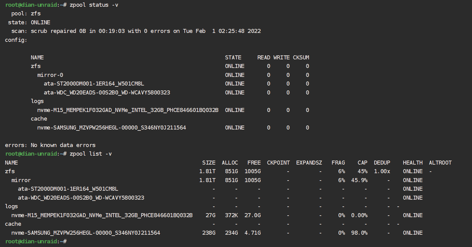

Sorry for the delay, @diannao please post an image with the result of the commands "zpool status -v" and "zpool list -v" ; this is the first step that the plugin performs to identify all the pools and then, list the datasets that belong to the pool; I will deploy a clone of the configuration that you post, so I can debug and update the plugin according to the results.

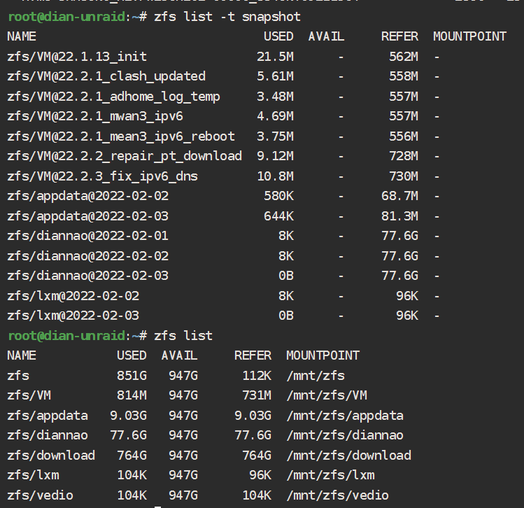

here is
Earlier in the day, the info of dataset in webui was working fine, and I didn't change my zpool configuration during this this time.
Do you think the bug might be related to the name of the snapshot?
Edited by diannao
I'm completely sure that is a parse error, however with the specifics I could modify the regular expressions to catch this case and the plugin to work properly; thanks for the info I get back to you when the update is live.

@JJJonesJr33 @diannao The fixed version is already live, as I'm planning a new version with additional features, the fix was applied to the current version; what that means is that you have to uninstall and install the plugin again in order to get the version with the fix.

I reinstalled version 2021.11.09a. But the problem is still not solved, am I getting the wrong version?

@diannao Now, I'm not so sure about your error, mainly because for the fix, I replicated your config and the plugin was working just fine; and on the other hand, you posted that at least the dataset info was working fine a couple of days back; I'm going to send you a PM with a set of commands to be executed, so I can debug in deep what is wrong with the plugin in your system.
