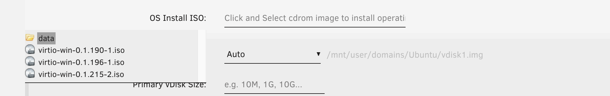

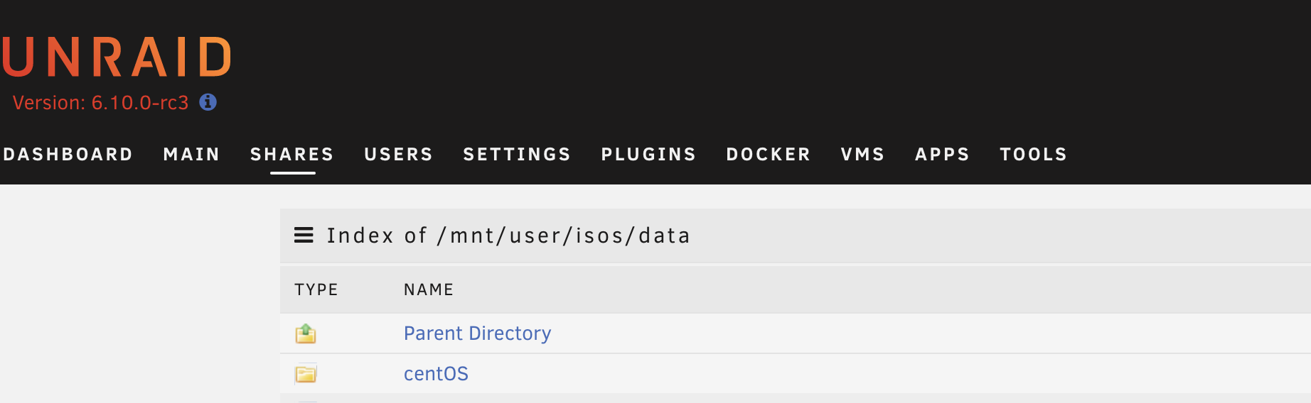

Also, am running into new issues with 6.10.0-rc3. While creating a new VM, the Unraid GUI is not able to follow a symbolic link to ZFS.
"data" is a symbolic link to ZFS. This was working fine with 6.9.2.
Strangely, browsing the Unraid Shares works as expected.
Why not use the ZFS directory?
Are you really sure this worked before? But this seems like a issue with GUI itself and should reported to the bug tracker for RC3.
Earlier I created Unraid Shares and replaced them with symbolic link to ZFS directory. Worked like charm apart from getxattr() errors, which I was fine with. However, with 6.10.0-rc3, browsing these shares and using them during VM creation wasn't an option since they simply wouldn't work. As an alternative, I moved the ZFS shares under smb-extra.conf.
I have reported these under RC3, since ZFS isn't a supported FS, support isn't guaranteed. :(

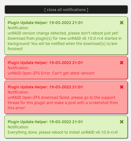

Just got this error while updating to UNRAID 6.10.0 rc4. I previously updated from rc1 to rc3 just fine. The server logs (the ones in the UI) don't seem to show anything valuable regarding this error?
Any ideas on how to re-trigger the download maybe? (Although I'm not sure why it failed in the first place, since the internet was working just fine.)

Lkkely you updated before new modules were ready. Takes about a hour after release. They will be downloaded at reboot. This helper justs pre downloads to improve boot time.
Ah, good to know that it's still possible to reboot then. I just updated like 7 minutes ago and on GitHub, it looked like they were ready. Not sure what exactly happened, but I guess I'll reboot later today (and see what happens).
As @SimonF said, it will be downloaded on boot. Don't know have to look into it why the helper fails with RC4.
@SimonF & @TheJulianJES investigated a little further and found the cause of the issue, the naming from the Linux Kernel version changed, updated the Plugin-Update-Helper to take that into account. Hopefully it will work next time.
It is safe to reboot because the plugins are downloaded on boot too, just make sure that you have a active Internet connection without any AdBlocking software in front of it.
If you don't have a active Internet connection on boot a plugin removal from the Plugin Error tab and a new installation will fix it.
