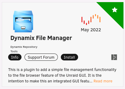

7 hours ago, theimmortal said:
manage the config files.
With the Dynamix File Manager you can already do that which is available in the CA App:

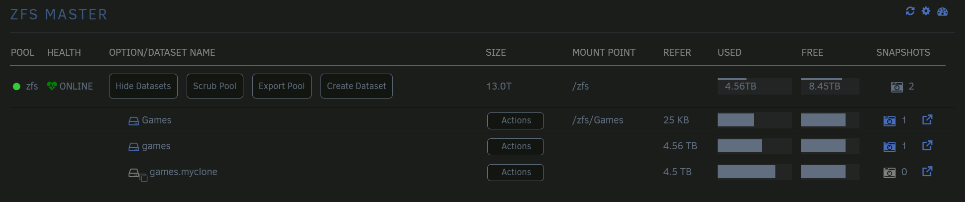

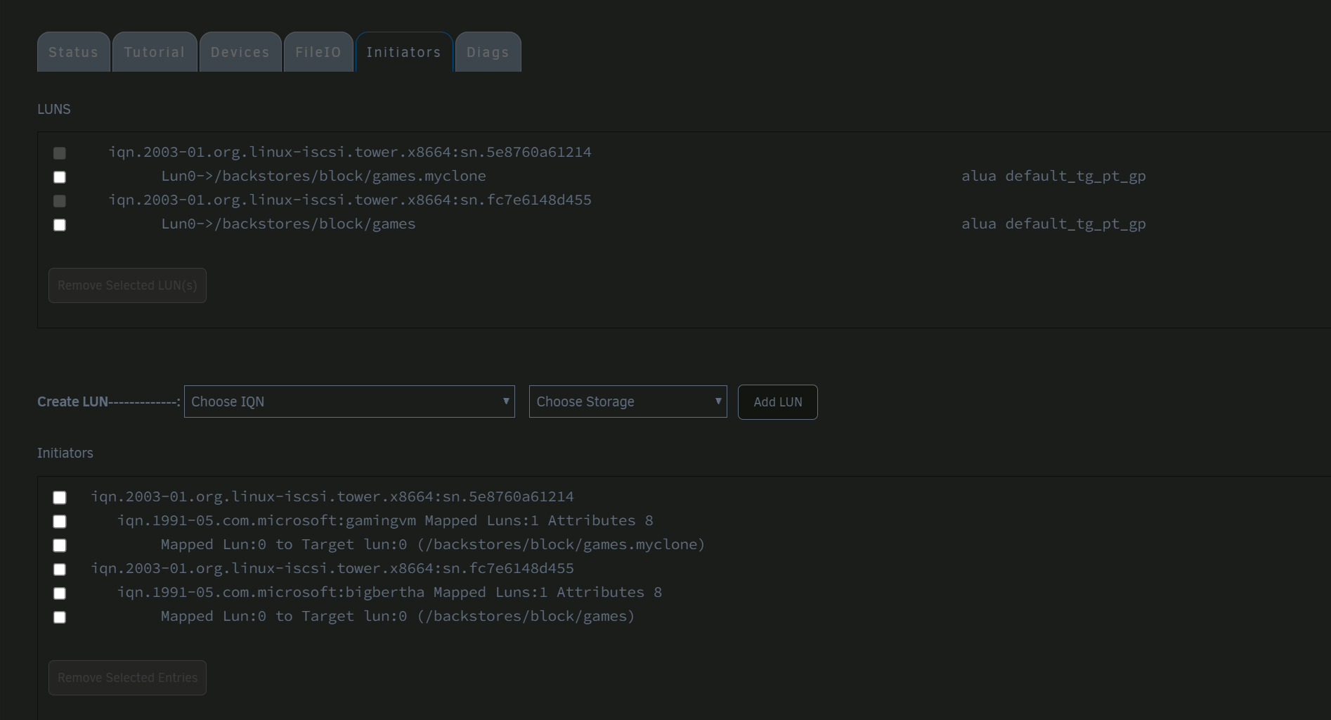

So i rebuild my ZFS array and learned a bit more to become more savvy in ZFS terms.
now i rock an 7x2TB el cheapo sata SSD Array, its purpose is to serve any VM and any PC in my Household its own shadow game library. Thanks to @subivoodoo & @ich777 i got the puzzle together and it works like charm, next step ist unterstanding how to reverse engineer his script :D
what i did
1)make an zfs array, how you like it. myne is named zfs
2)go to the Terminal and create an Dataset with this command
3)zfs create -s -V SizeYouWantG -o volblocksize=blocksizeYouWant zfs/nameOfYourDataset
example: zfs create -s -V 8192G -o volblocksize=4096 zfs/games
4)than you create an ZFS Blockdevice, still in the Terminal enter
5)targetcli
6)   /backstores/block create name=NameOfYourBlockdevice   dev=/dev/zvol/NameOfZFSPool/NameOfYourBlockdevice
example: /backstores/block create name=games dev=/dev/zvol/zfs/games
7)  cd /backstores/block/NameOfYourBlockdevice/
8 )set attribute block_size=4096
9) set attribute emulate_tpu=1
10) set attribute is_nonrot=1
 11) cd /
 12) exit
13) Now you can close the Terminal and go to the ISCSI Plugin and create an ISCSI connection to your Rig.
 14) Install all your Games on that drive
15) whan all games are installed we make an snapshot in the Terminal with the following commands
16) zfs snapshot NameOfYourZFSPool/NameOfYourBlockdevice@HowYouWantToNameYourSnapshot
example: zfs snapshot zfs/games@allgames
than we want to clone that
zfs clone -p zfs/games@allgames zfs/games.myclone
then again into
targetcli
/backstores/block create name=games.myclone dev=/dev/zvol/zfs/games.myclone
cd /backstores/block/games.myclone/
cd /
exit
and now you can mount that "cloned Blockdevice via ISCSI" dont forget to create an individual Target per VM/Baremetal/Rig :D
when you have new games installed than just go to the Terminal
targetcli
delete NameOfYourBlockdevice.myclone
cd /
exit
zfs destroy YOURPOOLNAME/NameOfYourBlockdevice.myclone
zfs destroy YOURPOOLNAME/NameOfYourBlockdevice@HowYouWantToNameYourSnapshot
than start over  @ 16) rinse and repeat
next scenario, you bought another 2TB of SSD storage just add it to your Array as usual than enter
zfs set volsize=newSizeofPoolG NameOfYourPool/NameOfYourDataset
example: zfs set volsize=13000G zfs/games
now you can add your new storage to your iscsi storage in Windows :D
thx @subivoodoo @ich777

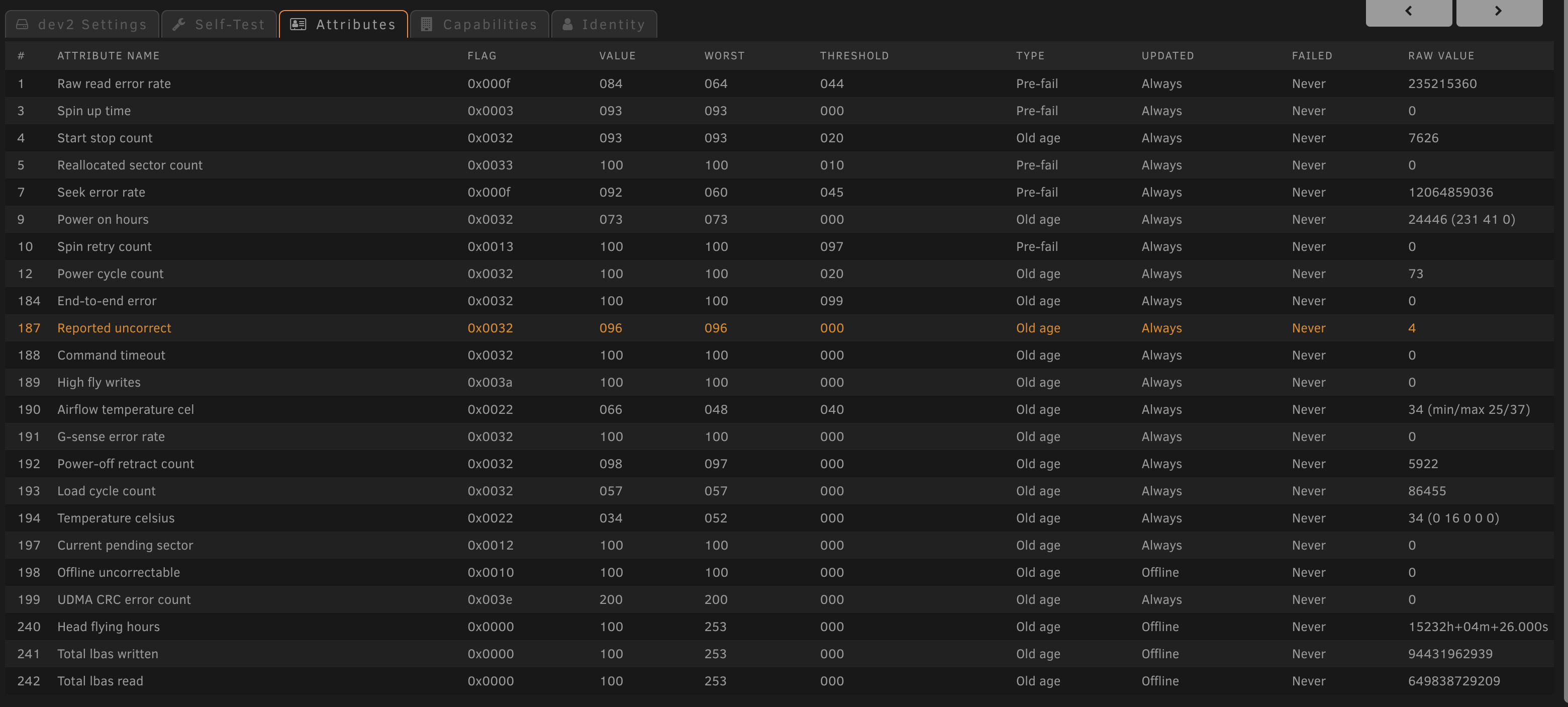

This is from the SMART test. does that yellow line mean the disk is buggered?11445831_Screenshot2023-02-18at8_13_39pm.thumb.png.384e19eb38f3593e473bc4034ec6183f.png

Sounds like a reason to worry. Run a full smart test.

Depends on your risk profile.  Your disk may fail soon, on the other hand I've had disks continue to operate for tens of thousands of hours with a handful of "reported uncorrect" errors.
