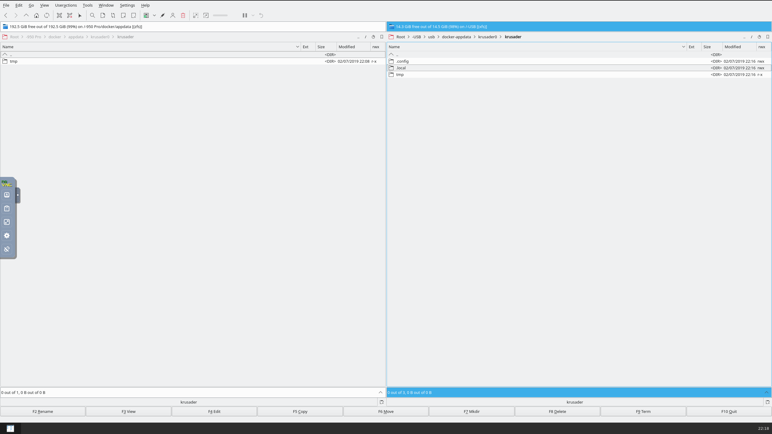

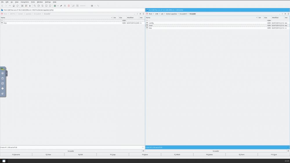

Mistakes were made - I'm still new to ZFS and have Docker issues
I was playing around a bit, and launched three new Krusader containers with the same template. One on my ZFS drive, another on my array USB, and another on my FreeNAS through UD's SMB, and I've noticed that the one in my ZFS gives me an error about being unable to save bookmarks. After, I took a look at the folder structure of each container and realized that the one in ZFS is incomplete (see image) missing the ".config" & ".local" folders, although, the one over SMB works as intended (though this is not the case with vdisks). The paths are as follows:
ZFS: /mnt/zfs/950/docker/appdata/krusader0
USB: /mnt/user/usb/docker-appdata/krusader0
SMB: /mnt/disks/FreeNAS_DataBass/Docker/AppData/Krusader
I don't mean to spam, but I'm getting concerned about populating it with more data, and then need to attempt to migrate it off and revert back to btrfs. But I suppose it wouldn't be too big an ordeal since I have FreeNAS on standby, I just would like to use ZFS locally right now until I can integrate FreeNAS better.
P.S. I also read up on chmod a bit and was able to clean up some files by using {chmod -R 777 folder/file} and then Krusader, but still struggling with the rest.
Edited by Basserra
Fired up another container through UD SMB
