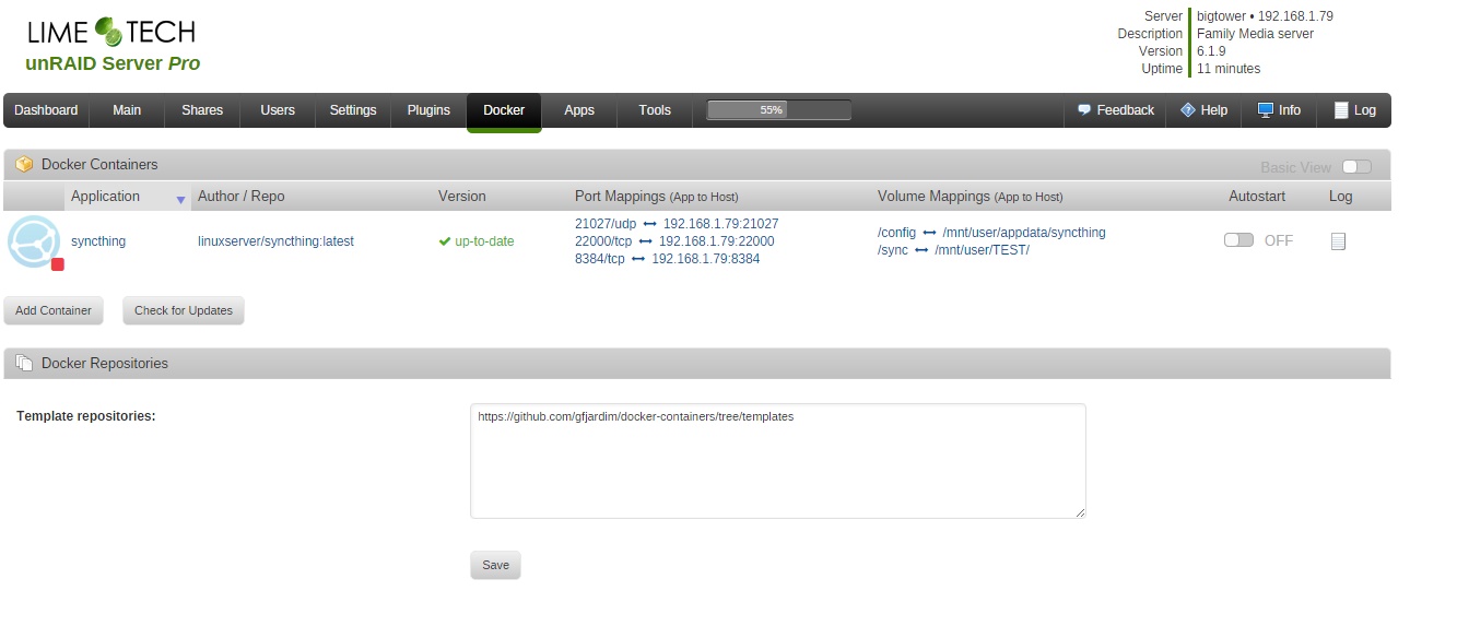

Can you post a copy of how you've got this setup. (Docker setup screenshot or something)
And try running
ls -ld /whatever/you/mapped/home/Sync/to
Sure!
Here is the result of the ls -ld
root@bigtower:/mnt/user# drwxrwxrwx 1 nobody users 53 Jun 27 15:41 /mnt/user/TEST//
-bash: drwxrwxrwx: command not found
and the screenshot I think you asked for is attached
Thanks in advance!

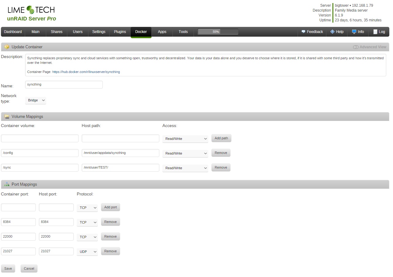

OK, few things.  First lets change to using /mnt/cache/ and not /mnt/user/ in the template.
Then let's delete the current appdata syncthing folder.
rm -rf /mnt/cache/appdata/syncthing/
Then lets make sure there are no other syncthing configs anywhere else on your array.
ls -lad /mnt/user/appdata/*
(Post the output of the above two commands in your next post.)
Also another screenshot of your syncthing setup but flick the advanced setting on...

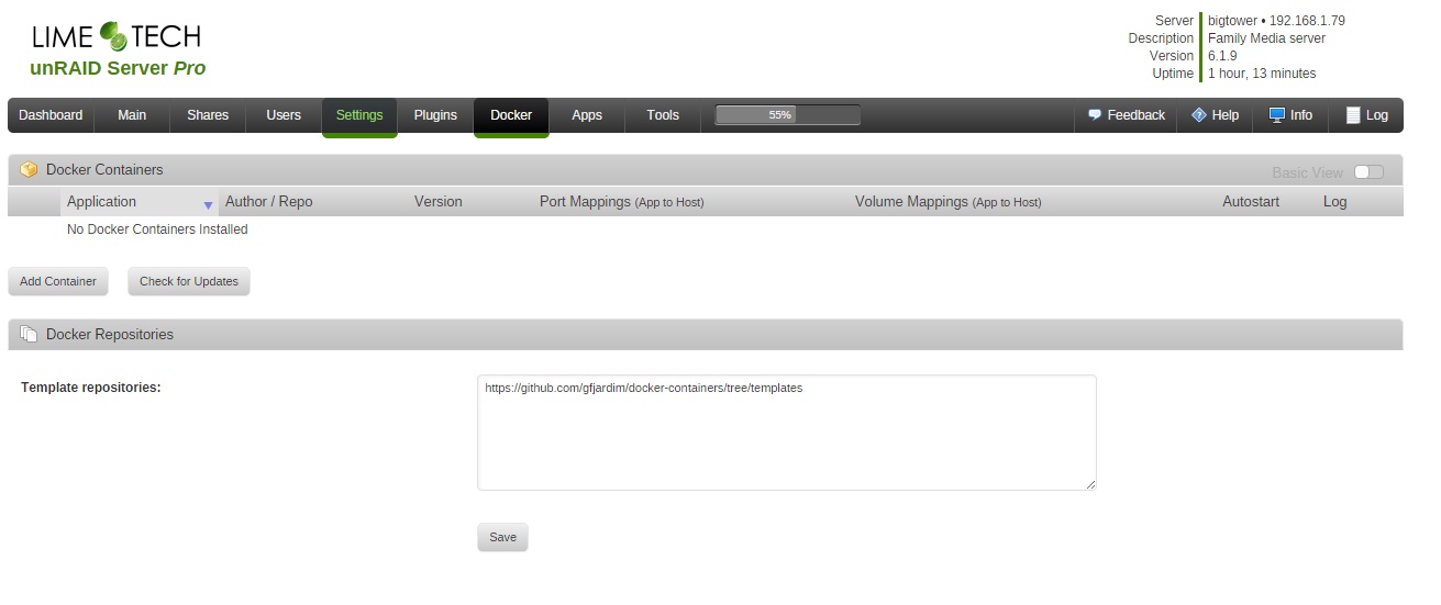

OK so have you made a share called appdata on your cache drive that is set to use cache ONLY?
And did you get my PM?
Image!! doh! ok, I am not sure if it was in a place it wasn't supposed to be but regardless, I wasn't paying attention. There was a docker.img file in /mnt/user/ so I nuked that and that seems to have done the trick screenshot attached.
Thnx (and thanks for your patience)
The docker.img file is the virtual drive which will hold all the docker containers.  There was no need to nuke that.  Just needed to click the syncthing docker icon and then select remove.  :o
Doh... well its done, docker isn't there.
Got your PM, will probably take you up on your offer.
In the meantime, your bit about a cache drive made me think no better time than the present to start one (didn't have one before). I am guessing I didn't have to go that route (ie another way) but figured, why not? I had a drive in the array that was quite a bit smaller so I went through the steps to remove it and turn it into a cache drive. As it was recommended that I do a parity check I am running that now and the est is a few day (am guessing its due to the combo of slow computer, small amt ram, lots of drives, etc?)
Anyway, its plugging along so I'll post when I've got things ready to take the next step.
Thanks!!
