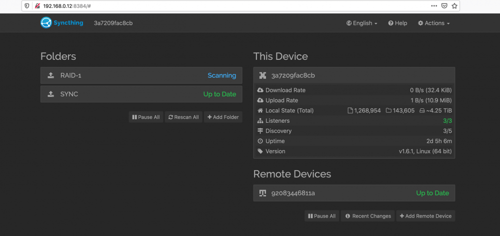

On 7/4/2020 at 1:31 AM, johnwhicker said:
This place id DEAD :)
This stuff ain't working :(   It scaned for 2 freaking days and now is STUCK.  Any ideas?  It won't move or transfer anything :(
2105054539_ScreenShot2020-07-03at6_29_55PM.thumb.png.cbbcc599dc4cb68678b5efa184dd8922.png
This place ain't as dead as your system will be with those settings in time. 😱
You are exposing your whole UNRAID operating system to the Syncthing docker:
DO NOT DO THIS.
What's even worse, it seems like a sync operation for your WHOLE OPERATING SYSTEM is in progress:
STOP SYNCTHING NOW.
The reason that Syncthing is stuck is because it is indexing your whole operating system (1,268,954 files!) and working in folders that it should not even come close to: potentially changing system files, messing with permissions and who knows what else. The whole point of Docker is to limit the exposure of your system to certain applications and "container"-ize applications in sandboxed environments, so they can do less harm when malfunctioning or when set up badly by the end-user.
I do not know how much damage is already done by that sync operation shown in your screenshots, but if you actually have it set up this way you can easily destroy both your parity and whole UNRAID configuration, if not lose your data.
Syncthing is way too risky a tool to just randomly expose folders without knowing what you are doing - sorry if this sounds harsh.
Please watch some tutorials on how Docker works, as well as UNRAID-specific Docker configuration tutorials.
You need to set up a user share and expose only that user share to your Syncthing instance - see explanation to the other user above.

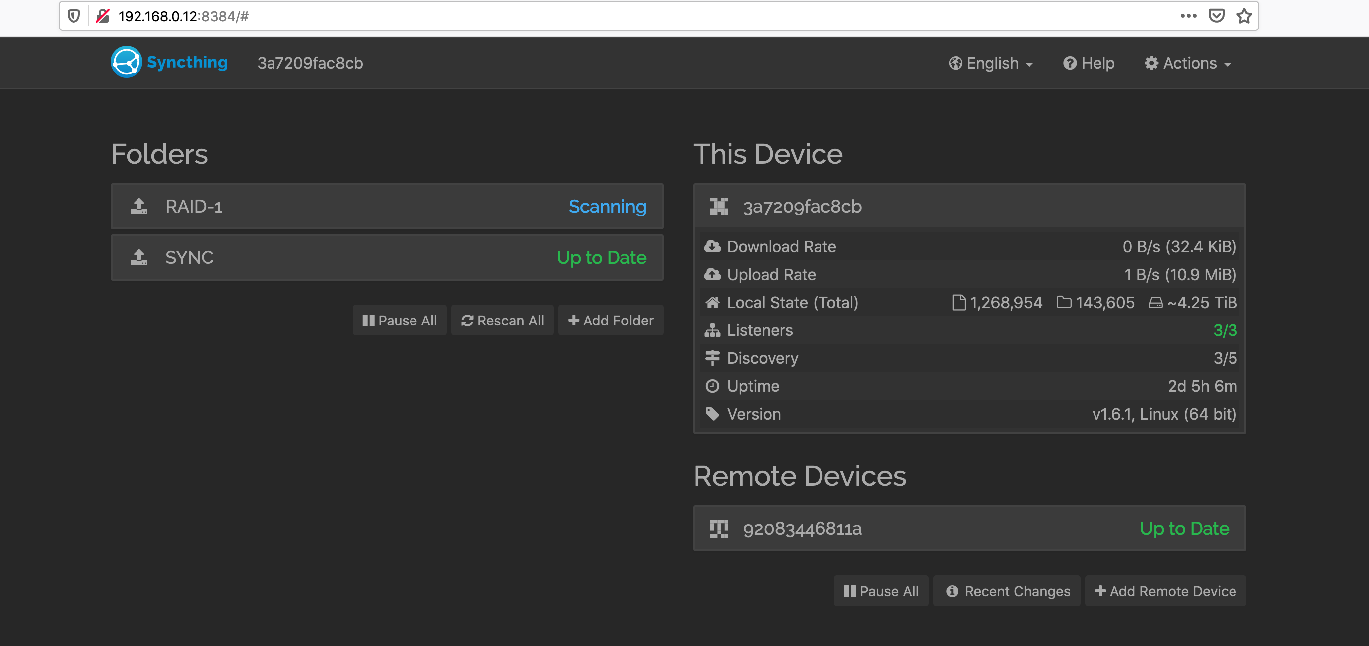

14 hours ago, Rysz said:
Do not do this - "/mnt/cache" is the disk share equivalent of the cache drive. If you make this available to your Syncthing instance it will clog up your cache drive and the synced files will not be moved to your disk array at all. This means the files will not be protected by parity and also that necessary cache space is taken away from other dockers, VMs etc...! Not being able to select this path in your Docker settings is actually a security mechanism to prevent exactly what you want to do. ;-)
What is meant by using the cache is that you should create a user share utilizing the cache, not only writing directly to the cache itself. If you create such a cache-enabled user share, you allow Syncthing to initially write files to the (fast) cache. This is especially useful because the system does not need to be kept busy trying to keep track of the parity while the files are still syncing/being built. The mover will later move the files to your (parity protected) array and free up space on the cache for new sync operations and other applications. This is a reasonable compromise between speed and a relatively short amount of unprotected time for the newly downloaded files, which the mover will later send to the protected array.
So if you want to get this set up you need to:
  • Create a user share with "Use cache (for new files/directories):" set to "Yes".
  • Expose this user share to Syncthing by editing your Syncthing container and setting the Host Path 2 accordingly.
  • Set the correct path in Syncthing's Web UI for your shared folder(s). (in this case starting with /sync/)
  • Make sure the mover is running on a schedule in order to move the files from cache to the array regularly.
    You can check this by clicking on "Schedule" on the Main page next to the "Check" button.
This is an example configuration assuming your setup:
  1. Gathering from your message you already have a user share called "syncthing" set up - good!
  2. Now edit this user share and enable the cache for it - set it to "Yes".
  3. Next edit your Syncthing Docker container and point Host Path 2 (/sync) to "/mnt/user/syncthing/".
  4. In your Syncthing web interface create a new shared folder and point it to "/sync/" or "/sync/<folder name>" if you have multiple shares.
  5. You got it all set up - share this folder as usual. 🙂
DO NOT DO THIS.
STOP SYNCTHING NOW.
Thanks much. I moved on already. Command line and scripting is king  :) I tried several ways and didn't work well. Perhaps too much data, who knows.
RAID-1 actually was not my operating system or the entire system.  Is basically an 8TB drive that I used  for a share named RAID-1. The high number of files was basically all video and pictures that I store there.
I didn't hurt any unraid to operating system during this process :)
Thanks again for responding Sir

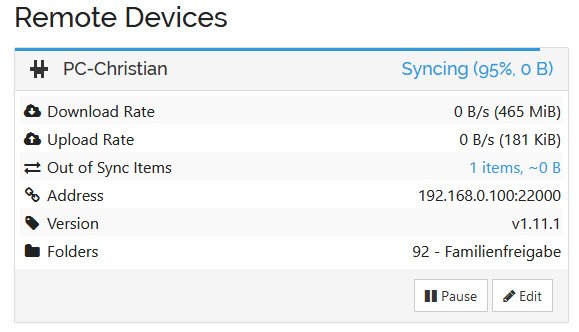

I installed Syncthing and it works great so far.
But I have one issue:
For testing I copied a 500 MB File to a sorce-folder that should be synced via Syncthing to the Unraid-Share.
The sync have started, but I deleted this file at the source-folder before syncing has completed.
Now I get at the summary "Syncing 95%" and the deleted file as "Out of Sync Items". See screenshot:
Is there a way, maybe under Settings -> Advanced -> Folder, that Syncthing figures out,
that the file was in the meantime deleted and has not to be synced in the future?
A rescan showed no success of this status.
Thanks and best regards.
Edit:
For some reaseon I've seen that in the source-folder the 500 MB file was still there (don't know why),
but on the Unraid-Share not (which is ok).
As soon I deleted the file from the source folder the sync was "Up to date" again.
Edited by Padi75

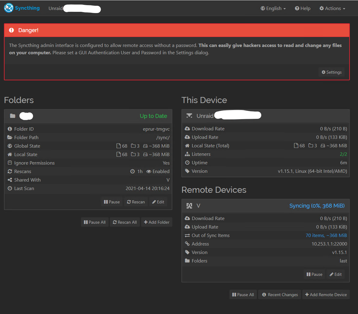

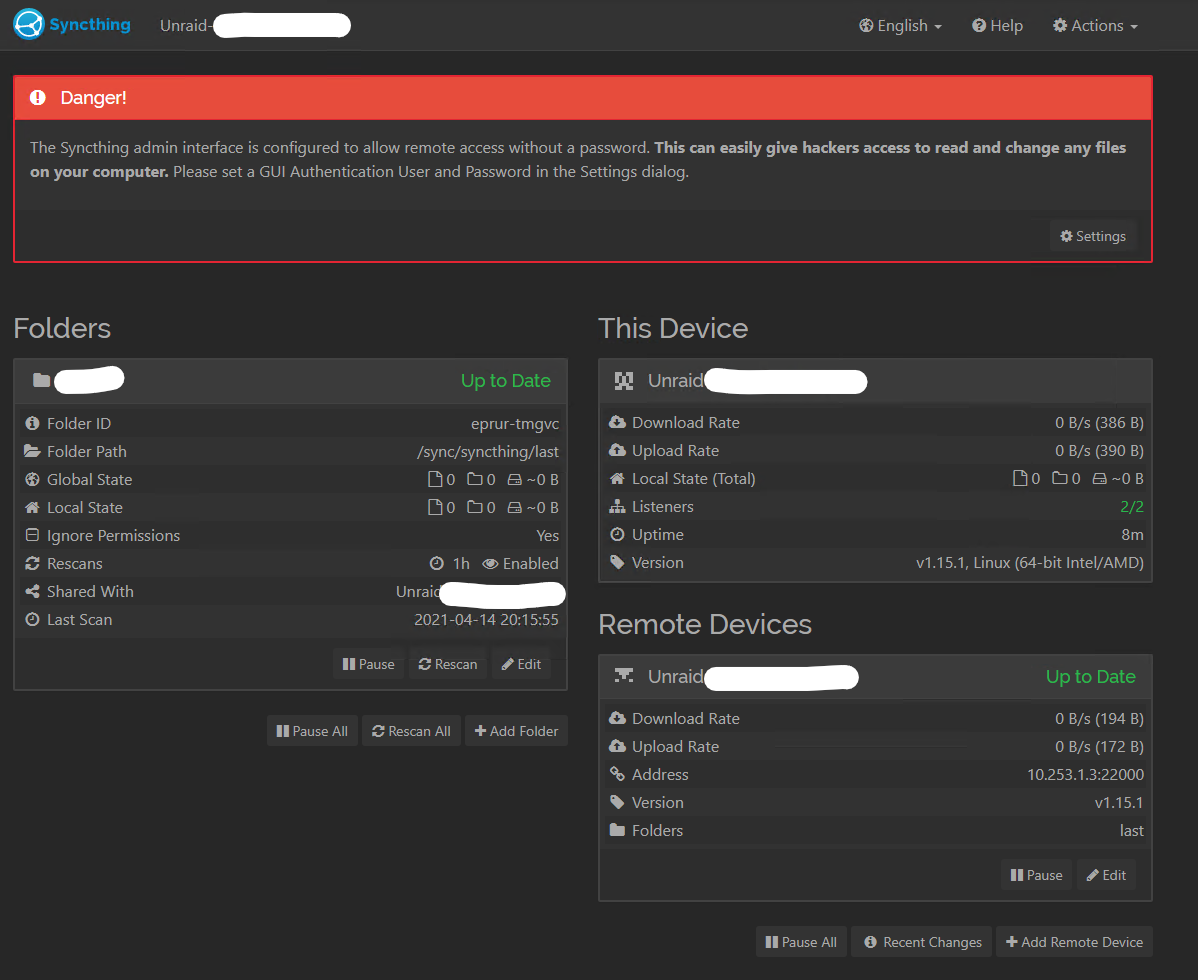

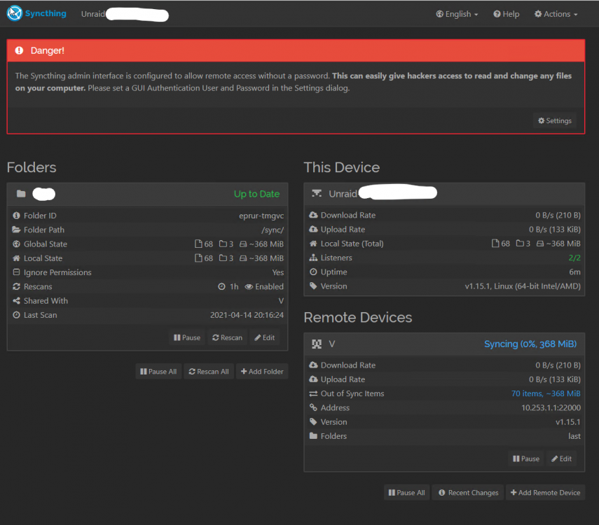

I literally cant get syncthing to work with my shares.
To my setup:
I got two unraid server connected via the WireGuard VPN plugin. Both servers are running the latest version of this container and are connected in the syncthing gui. When im sharing the default folder (which is just running inside the container) everything is syncing fine and super fast.
When i try to sync one of my unraid shares (by mounting it as RW into the docker of the main server) + sharing the folder with the other server it starts the sync process but gets stuck at 0%. The target server does not even state that a sync is running.
So there has to be an issue with the mounted share/the files in the share.
As long as i mount an empty share and i am creating the files in the share from within the container the sync is running fine.
"Ignore Permissions" is checked on both ends and "UMASK_SET" has the value "000".
Can someone tell me whats wrong with my files in the share that causes the sync process to get stuck?
