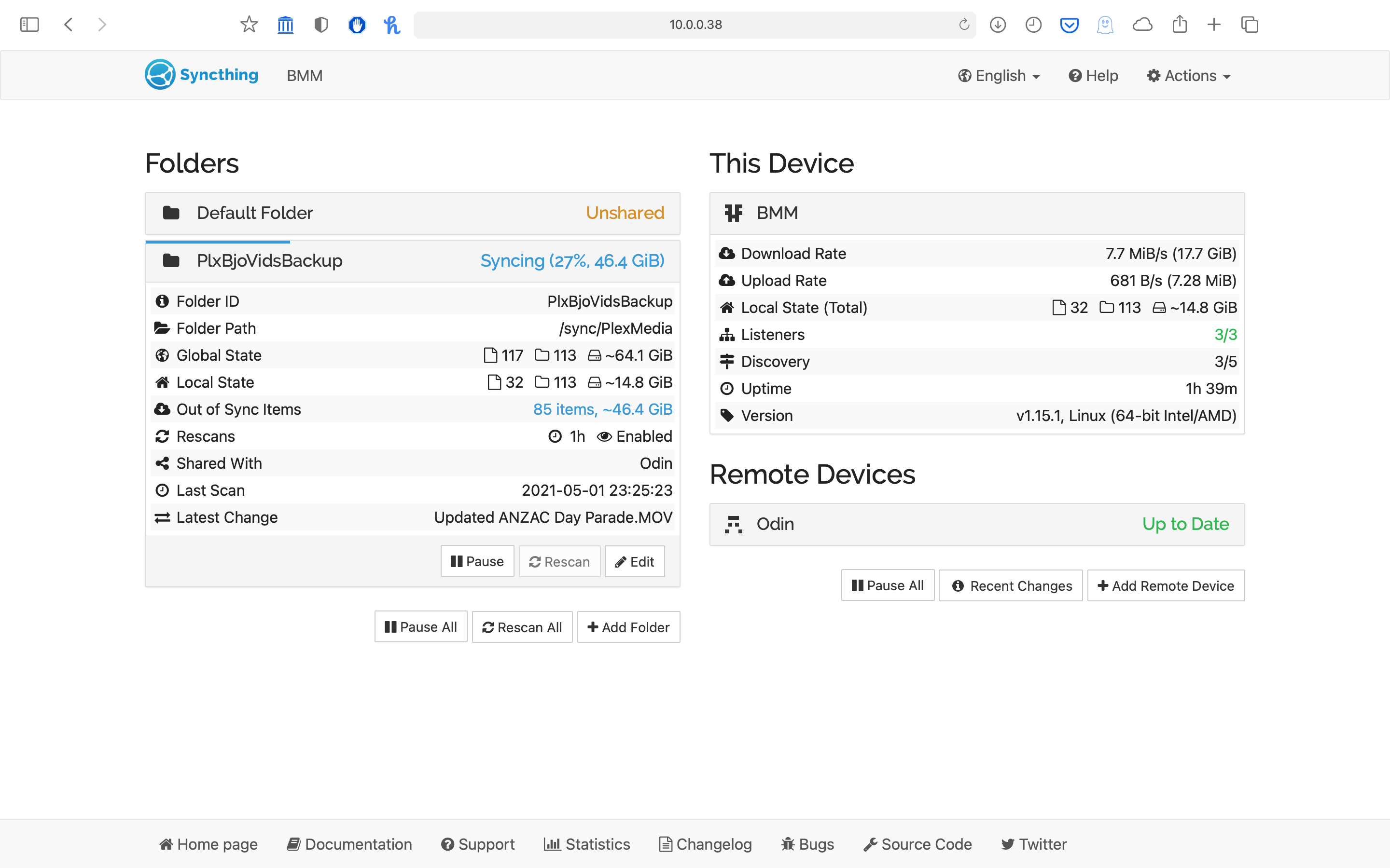

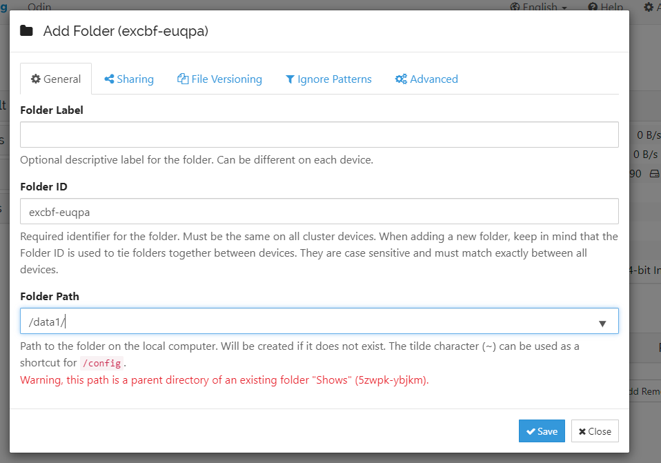

6.9.2. Thought I'd just clarify regarding the specifying of pathways in SyncThing. I'm transferring files from a backup server to my Plex Share "PlexMedia" within Unraid. I specified the folder path as /sync/PlexMedia, SyncThing was able to see the share and is now transferring files. One issue however was upon navigating to the PlexMedia share on Unraid from my desktop, I found the folder to be empty. Is there a chance I may be specifying the wrong directory and inadvertently sending the files elsewhere? I have a screenshot below for context.

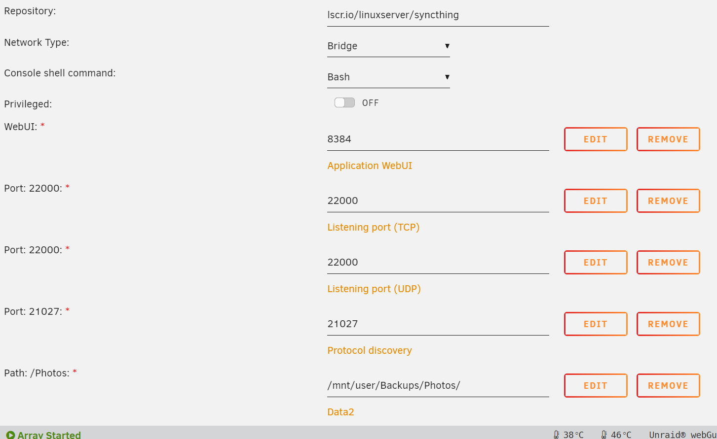

Hi Hoping someone can help me.
I have set syncthing up to sync the photos i take on my phone to a folder on my server but when i try to delete unwanted items it says i need permission from Server\nobody to make changes
have i done something wrong here?
I came here with the exact same question. I can tell you that going to Unraid webGui > Tools > New Permissions and then running it against the share(s) with your Syncthing files will fix it so that you can edit the files that Syncthing has moved around.
Edited by smashingtool
Thanks for the info.  i have also found that if you create the root folder yourself the files syncthing place in it are also ok

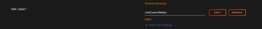

The instructions is not that informative when installing syncthing..
The instructions says:
-v /data1 Data1
-v /data2 Data2
But what is Data1 and Data2??? Please, make a better explanation rather than just describe it as data1 and 2.  Sorry, but you can rather left the description out rather than print the same again.
-v /data1 Data1
-v /data2 Data2
The naming here is confusing but the data1 and data2 are the directories that you are passing into the container. For example, if you want to pass you Media share into the container you'd put /mnt/user/Media into Path /data1.Capture.thumb.PNG.52e00711283ba439a8c0df90f6d379d8.PNG
Now everything in your Media share will show up in /data1 directory within the container.Capture1.PNG.8d98621b49e4ec689e10bdf0ff9d7465.PNG
Same thing with data2. I'm only using syncthing to sync my media share with another unraid server so I removed the data2 variable.

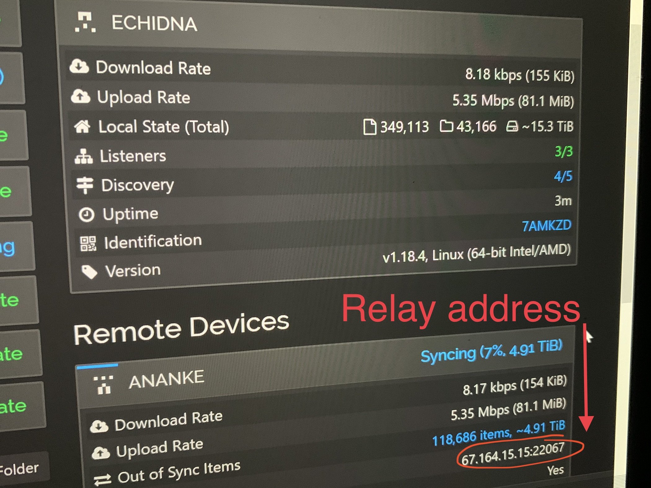

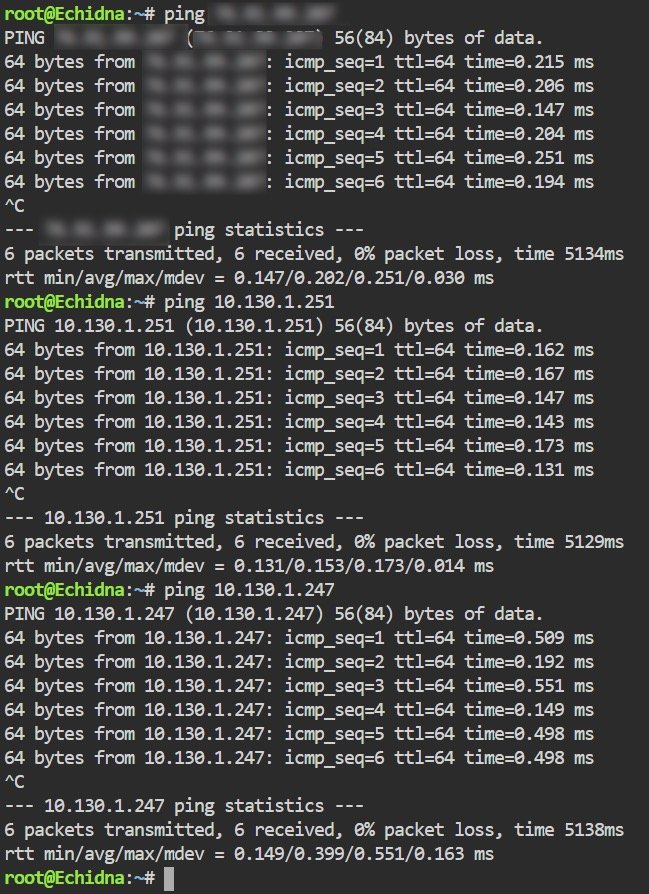

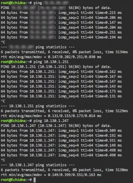

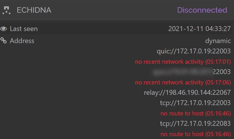

So I've been trying to figure out what I believe should be a permission issue. I have 4 syncthing installs on various boxes (Unraid, 2x Windows, Synology). I can get Windows > Unraid to pair just fine as well as Windows > Synology. However, I cannot seem to get Unraid > Synology or vice versa. Both Unraid and Synology run linuxserver io Syncthing docker. The connection addresses on each of those, when left to dynamic show several relay addresses and my public facing ip.
At no point can I get them to see the other syncthing instance's machine ip.
I thought maybe the Unraid host was being firewalled or something in that nature but a ping check from the host to the other machines and WAN shows everything is working normally.750DF175-AA7F-4FF6-9DF8-84CFF26B3A38.jpeg.f8f38c7d6e754d8224a732ea126653e5.jpeg
I've dug through the docker documentation as at one point I believed it to be related to the networking setting within each docker image, but that seems to have turned out being incorrect.
A different forum resource along with the syncthing github made it seem like there could have possibly been a bug in the 1.18.x version of syncthing but i don't know much more than that atm.
EDIT: I forgot to add that when I connect from either Unraid/Synology with Windows I can see their static IP. I'm not entirely sure what IP I see from windows to Unraid but I believe that sees a relay. Will double check since it seems important to be sure of.
EDIT2: In the docker tab under the configured port access mappings, which cannot be changed in the image config settings, these address mappings show up:
172.17.0.5:21027/UDP10.130.1.243:21027
172.17.0.5:22000/TCP10.130.1.243:22000
172.17.0.5:22000/UDP10.130.1.243:22000
These seem to look very similar to the addresses syncthing is using in one of my other screenshots with a 172.17.x.x address. I’ve thought about adding these addresses as virtual IP’s to the firewall but have no real reason to believe they are even coming up on its end.
EDIT3: Issue resolved. Adding in firewall rules to the Unraid and Synology boxes to the NIC of the firewall allowed them to communicate. Something seems off there tho as I do not have any static routes that would route traffic in traffic this way. I’m inclined to believe the possible bug issue from the other forum resource i mentioned is the cause. SyncTrayzor seems to be wrapped around a previous syncthing build that didn’t map traffic in this manner but I cannot be certain as I do not recall a syncthing version mentioned in there before.
Edited by Soiled.Tomato

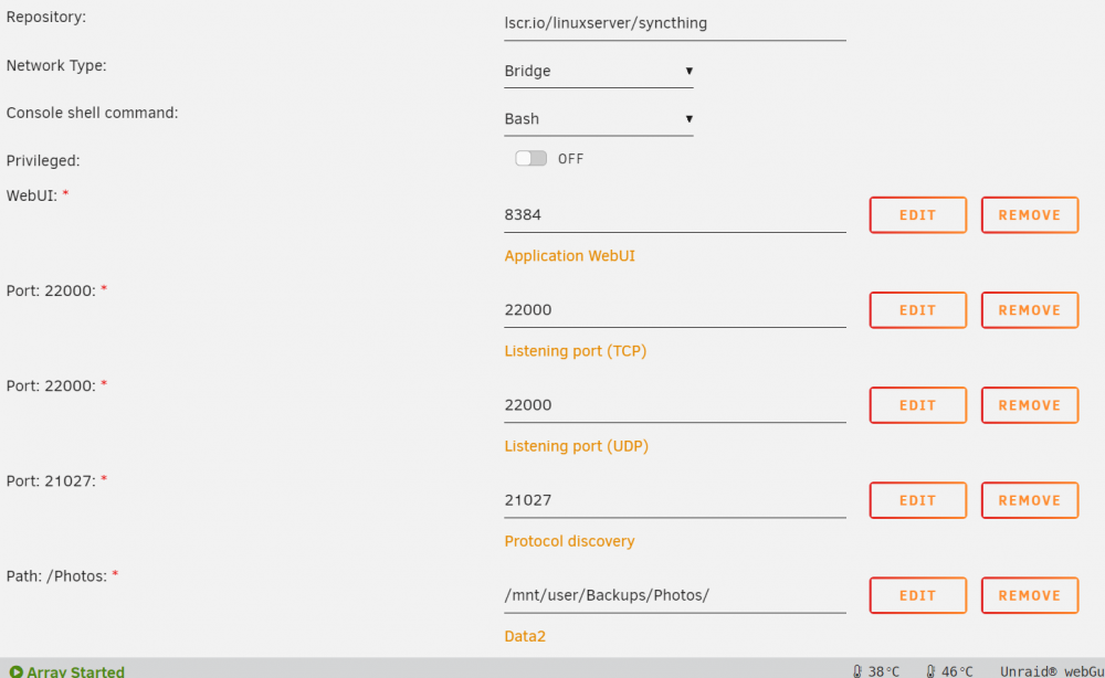

Hi, I want to use syncthing in lscr.io/linuxserver/syncthing but I dont understand the meaning of paths for data1 and data2. Can you give me more infomathin about the paths? Thanks.

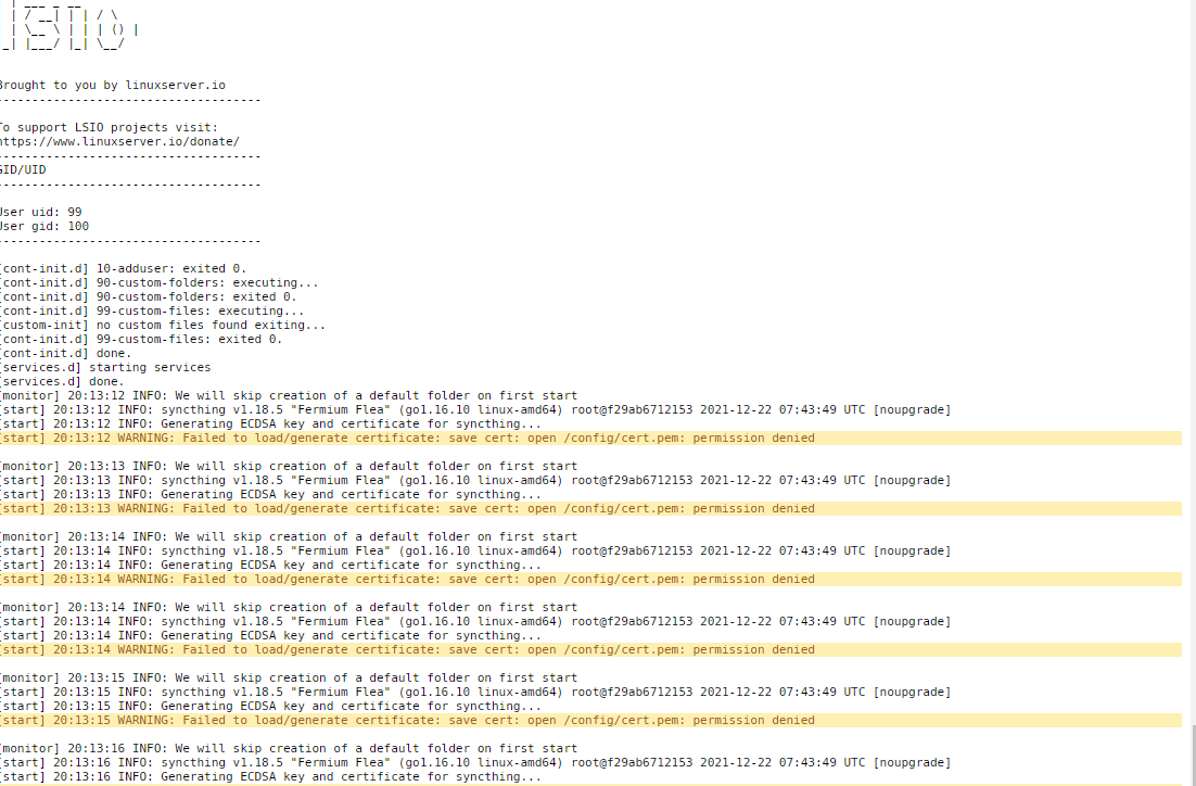

HI Guys,
I dont know if this the place for some Syncthing help. I have move my docker images and configs from one drive to another drive and now i'm getting a weird error when i spin up the syncthing container. when the container starts i get a " WARNING: Failed to load/generate certificate: save cert: open /config/cert.pem: permission denied" in the log files. The data is stored on and drive  using unassigned drives.
Any help with this would be great. Thank you.

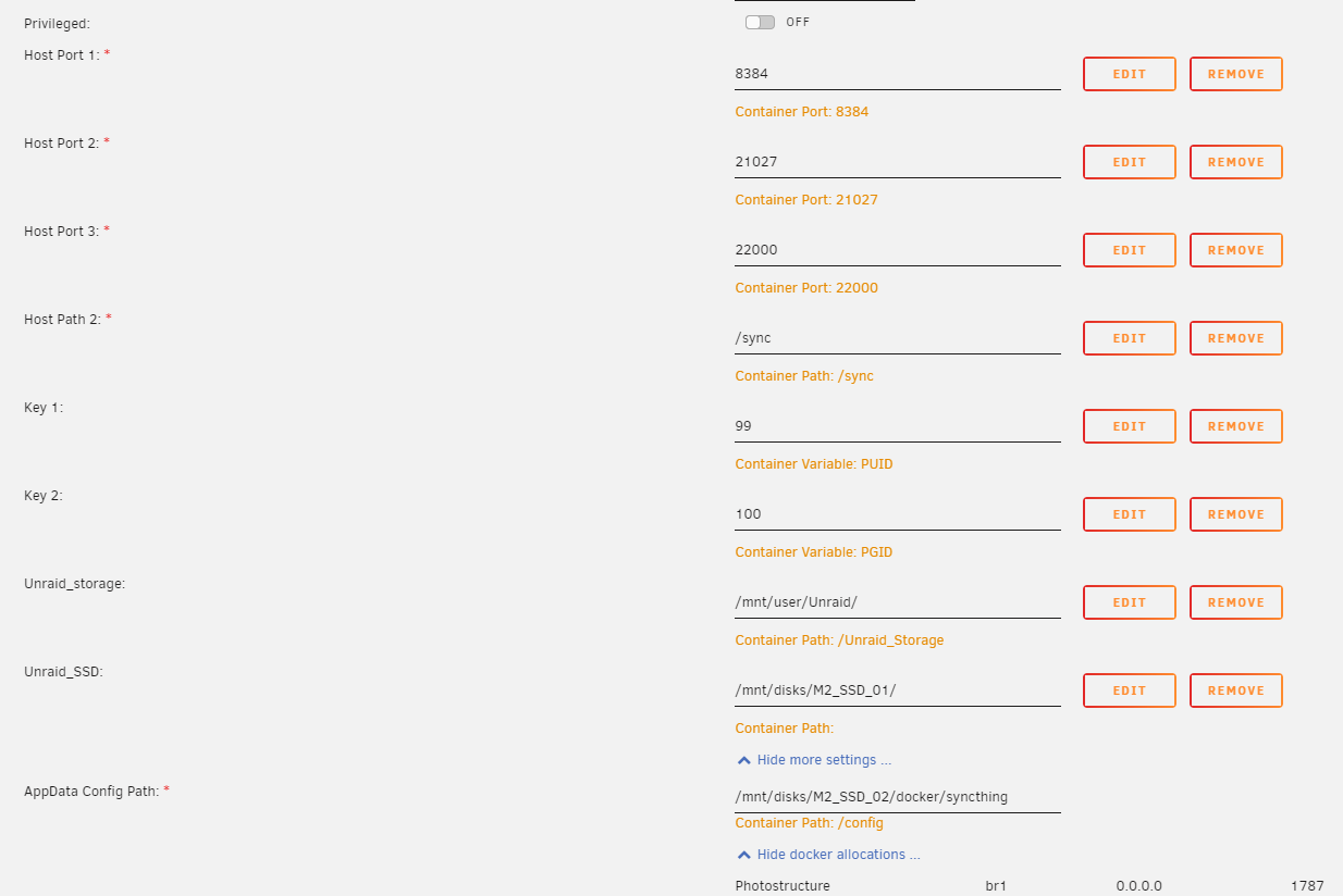

So perhaps this is an embarrassing question, but while I got the docker running just fine and syncing up with devices works, the location of the folders on the Unraid server side are not where I want them to be. Perhaps I am gravely misunderstanding how the /data1/ and /data2/ folders are supposed to work.
I want the synced folders on my PCs/Phone to be stored and show up in a separate SMB share so I can read & write to the folders from my File explorer. I created a share in Unraid, lets call it 'sync'.
In my docker setup I put in the appdata in (as per default) :
/mnt/user/appdata/syncthing
and for  "Path: /data1:"  I put in the created share:
/mnt/user/sync/
Started up the docker, it works just fine, the default folder is at "/config/Sync" , i.e. the appdata/syncthing/Sync folder (not sure if it is named "sync" by default or if it is because I named the data1 folder "sync").
So the folders in syncthing are now WITHIN the appdata subfolder, not in the desired separate "sync" share
I tried changing the default folder (and shared folders from other devices) to be in /sync/ instead of /config/sync but then I get a permission denied message.
If this is not possible, should I create a share in Unraid for the default folder within the /appdata/syncthing/ folder? Or do I need to share the whole appdata/syncthing folder? I'd like to avoid that if possible.
Thanks for the help :)

@Ghostwalker42 were you able to resolve this? I'm having the same issue suddenly after having been running the container for years.

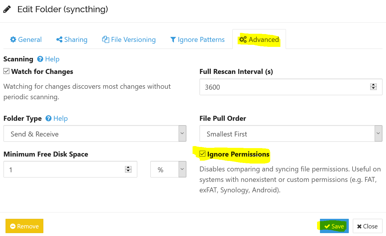

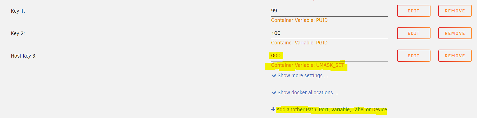

On 10/26/2020 at 7:24 AM, Rysz said:
For anyone experiencing write-permission errors on Samba shares as I did, please make sure that:
  • Syncthing Container (Docker) configuration has a configuration key set as follows:
    UMASK_SET => 000 (UMASK_SET as "Key" / 000 as "Value")
    Such a key can be added by clicking on "Add another Path, Port, Variable, Label or Device".
  • to enable "Ignore Permissions" on each individual shared folder inside the Syncthing Web UI on your UNRAID machine.
I have been investigating for hours why my files would keep ending up with the wrong permissions despite the supposedly correct UMASK of 000. Syncthing will, by default, try to synchronize the file permissions when exchanging data between two machines - beware of this functionality. Especially if you sync folders between another Linux machine and your UNRAID machine, Syncthing will initially create the file on your UNRAID machine respecting the UMASK 000 but later modify the permissions to reflect those on the original machine.
By ensuring that your synced folders are all set to "ignore permissions", you basically tell Synthing to stay out of setting permissions altogether and respect the default local permissions. (which you have previously set by handing the UMASK 000 to the container)
Hope this helps anyone experiencing permission troubles on Samba shares. 🙂

For anyone from the future encountering the issue:
I was able to solve it with chmod nobody:users -R /mnt/user/appdata/syncthing and ensuring I had PUID and PGID set to 99 and 100 respectively, in the container's docker config.
/mnt/user/sync/
Had exact same issue with my config. Tried to troubleshoot it for hours with no luck. Finally switched to binhex container and it works flawlessly.
