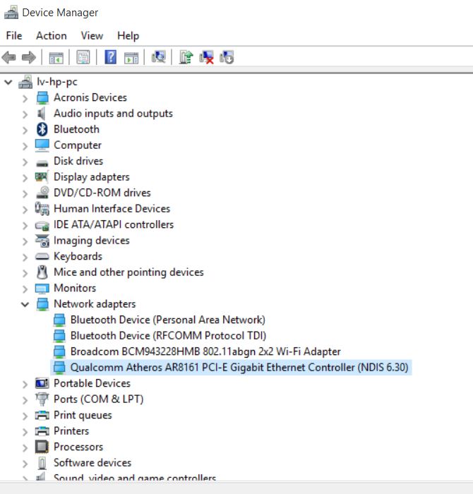

Unraid must not like this onboard ethernet.  I rebooted with a win 10 hd see attached for dev mgr.  The system is rock solid same network and no disconnect.
It almost seems like the unraid driver can't negotiate
