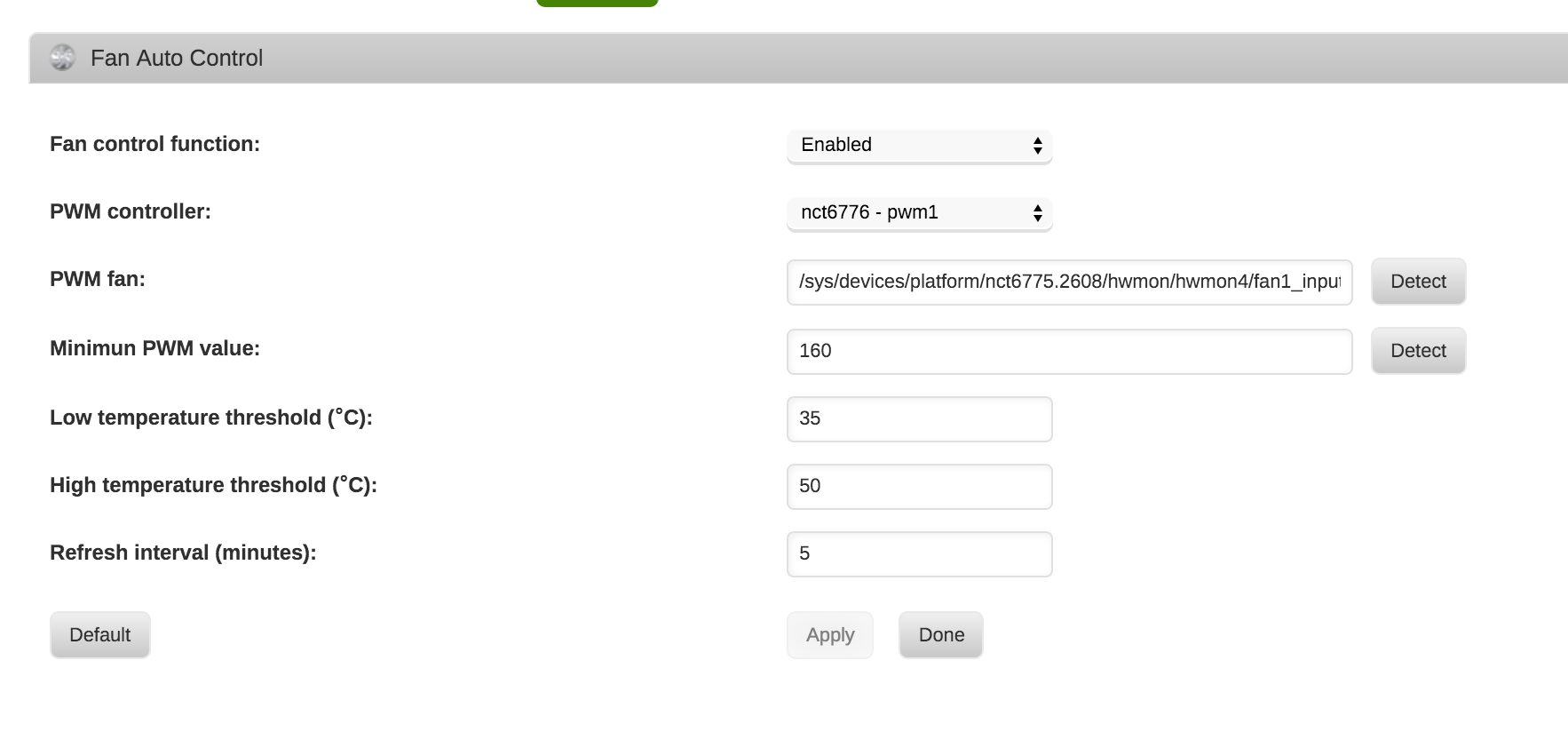

Now to control my 3 HDD array fans I use the Dynamix Auto Fan Control.
What the plugin doesnt tell you it only bases itself by HDD temperature :)
Config as follows:
width=800http://i.imgur.com/VhDnCXk.png[/img]

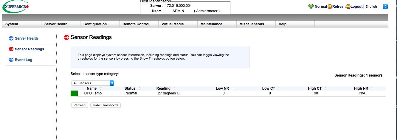

Thanks, will try in the evening and update. Another question meanwhile, when I login into IPMI web interface, Server Health -> Sensor Readings I see it displays CPU temp only. Not any FAN(s) readings like it is mentioned in step 3 of https://calvin.me/quick-how-to-decrease-ipmi-fan-threshold/ (again, I did not run any IPMI commands to change the settings, just wondering if the IPMI web interface is supposed to display any fan readings or not).
You should see all sensors not only cpu + all fans FAN1 - A. Try scrolling down maybe?
Nope; I tried using different browsers. Since the time I bought this board, I don't see any sensors other than CPU  :-[. I am running latest BIOS and IPMI firmware. See attached screenshot.
That is weird.

[/quote i see CPU Temp only.
;D tried in Windows, Mac on Chrome, FireFox, Safari. Even IPMIView iOS app I see CPU Temp only.

Bought it new from Newegg in Sep 2013. Planning to reset the BIOS and IPMI config this evening. Will report back my findings. I sent an email to Supermicro support as well, will see how they would respond.
Just did a IPMI Reset and boooom.. I see all sensors now  :)
23 of them

# Configuration file generated by pwmconfig, changes will be lost
INTERVAL=10
DEVPATH=hwmon5=devices/platform/nct6775.2608
DEVNAME=hwmon5=nct6776
FCTEMPS= hwmon5/pwm2=
FCFANS= hwmon5/pwm2=hwmon5/fan4_input+hwmon5/fan3_input+hwmon5/fan2_input
MINTEMP= hwmon5/pwm2=20
MAXTEMP= hwmon5/pwm2=60
MINSTART= hwmon5/pwm2=100
MINSTOP= hwmon5/pwm2=50
MINPWM=hwmon5/pwm2=50
MAXPWM=hwmon5/pwm2=255
Note that FCTEMPS is kind of empty, compared to yours!
When I try to test it, here are my results:
echo 10 >  /sys/class/hwmon/hwmon5/pwm2        --- stops and immediately restarts the rear two fans (connected to FAN2 & FAN4) - DOES NOT impact CPU Fan (connected to FAN1)
echo 10 >  /sys/class/hwmon/hwmon5/fan1_input  --- throws an error: -bash: /sys/class/hwmon/hwmon5/fan1_input: Permission denied
So basically CPU fan is not changing its speed
1. reason it's empty is because you didn't specify which input should control temperature.
2.
FAN 1 is probably still spinning, but slower?
Reason it would restart if the fan stops, and ipmi sees speed 0 (set in thresholds) boom it forces fans to restart.
3.
you cant do this this is an input.
Yeah, you are right. Instead of selecting an option number in pwmconfig, I was typing whole sensor name. Now, here is the updated config file:

However, echo 10 >  /sys/class/hwmon/hwmon5/pwm2 does NOT slowdown or stop the CPU fan. Any thoughts?
Thanks a lot for answering all my questions!
Try other pwms :) try pwm1 2 3 etc.... see what system does Fans 1 - 4 should be all controlled by single pwm file FANA separate
No LUCK. Can you help me by repeating your wiring setup?
FAN1 -> pwm spliter -> Case Fans and CPU Fan
FANA1 -> HDD Fans
Correct? If so, I shall also wait for my pwm spliter to arrive and try.
