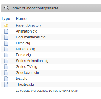

I went in the flash directories in the boot/config/shares and found the cfg files for each shares.
none are mounted.
