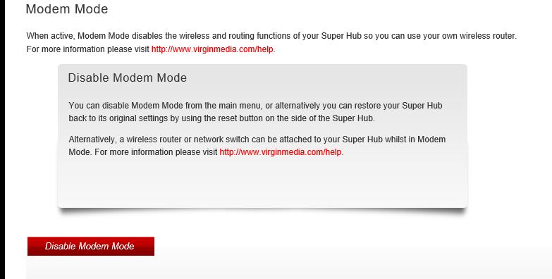

My network has vigin media superhub, running in modem mode.
Linksys wifi router, directly connected to this is the unraid server and a couple of network switches.

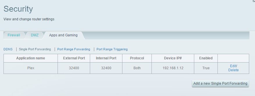

Yes, attached is a snip of the linksys settings as per the port forward web guide.
See here
I looked at this, I have both external & internal ports set at 32400 - I assume that is correct?

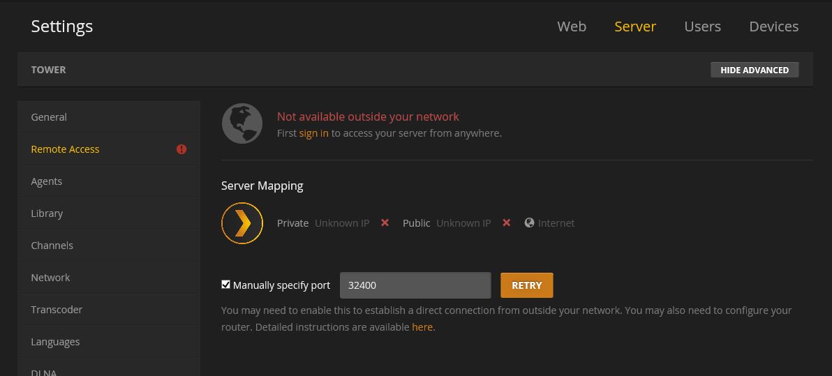

Thanks, I can go to that section of the web app I get the attached view, with the errors Private unknown ip
Public unkown ip
The internet seems to be fine, is there a setting within the plex unraid to give the correct ip?

Its a Linksys EA6300, unfortunately it has to plug into the netgear POS Virign media call a super hub.
Thanks again for the replies
AHA! I think we may have gotten the critical piece of information. What is the IP address that shows up in the WAN or Internet portion of the status page in the Linksys webgui?
Yep, good catch.  The Virgin SuperHub is likely not in bridge mode, so there's a double-NAT going on.  If so, will need to either get the SUperHub into bridge mode, or port forward on both routers.
Thanks guys
I like this enthusiasm, hope you have really stumbled on something.
Just in case you are heading Nas - I just re-checked again its not double nas.
my wan is 80.---.---.--- and appears the same in the linksys, virgin modem and on whatismyip.com
-my understanding is if it was double nas the wan would change
The virgin modem status is modem mode -see attachment -essentially it puts it into bridge mode and gives over control to the linksys.
Well, that's not your problem then.  :-\
And yes, you are correct of it were a double NAT the WAN IP would change.  It would be a public address in the SuperHub (like 80.192.78.229), but would be a private address in the Linksys (like 192.168.1.1 or 10.0.0.1).

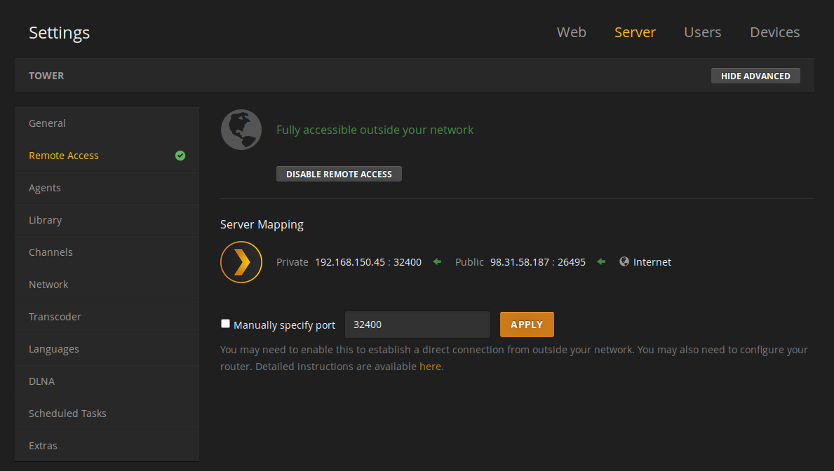

Got to ask again:
A few stupid questions before committing to the destruction at the weekend:
Is it better to update over the existing system
or
Just bite the bullet, format the flash and start fresh?
If its full start form scratch, is my data safe?
Any settings I should take a note off - going to take a screen shot of the drive set up, anything else?
Any registration details on the USB flash, or is that picked up but unraid?
Any advice on the above?
You shouldn't need to reformat from scratch.  I do not know if you can update straight from beta10a to 6.1.3 or how it would be done (I don't recall if beta10 had the "check for updates" functionality).  Maybe someone here can chime in.
If you were to start from scratch, yes your data would be safe.  The key item here is to know which drive is parity and which drives are data.  I would screenshot the current main page for reference.  After the flash reformat you need to assign the parity drive to the parity slot, and data drives to the data slots (order does not matter with data drives), and start the array.  Any shares you already have will be automatically generated (any top level folder on any data drive is considered a share), although you would need to reset the options on the shares themselves back to however you had it set up before.
As for the registration details, there is a key file on your existing flash drive.  It is called xxxxx.key (where xxxxx is your version of unRAID, i.e. Pro, Plus, etc.).  I have a Plus license so my key is called Plus.key.  It will be located in the config folder on the flash.  You need to copy that key off first and replace it on the rebuilt key.
