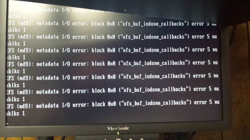

Over night I tried copying the data off of the "bad" disk, and the process stalled, errors showed up on a different disk, one that precleared twice before going into the system about a week ago, and now again, I cannot remotely reboot the server and only 4 disks out of 13 show up in the midnight commander. Should I downgrade to the earlier version of the unRaid? Everything was smooth with 6.0
Attached is what is on the screen of the monitor directly attached to the server.

What is the current state of your array? Is the disk still being emulated? If so, you should forget about that disk and get your array back to normal by rebuilding, not copying, its contents onto a new drive. Then when things are working again you can try to determine if that disk is worth keeping.
