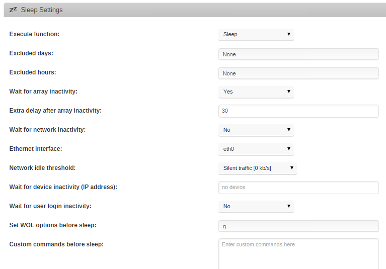

I had SimpleFeatures with V5, and sleep was working fine there..
After the upgrade to V6, I've installed the Sleep add-on, and turned it on but the array is still ON.

You can turn on DEBUG which logs the events and use that as verification.
Your settings should put the system to sleep 30 minutes after all disks went into standby mode, do you have something (docker/VM) running which may prevent this?

For testing purposes, enable DEBUG then use the Spin Down button, and wait 30 minutes (or change to a lower time) to see if sleep kicks in.
Tip: set DEBUG to syslog and use the Log button to open and monitor the syslog in real-time.
