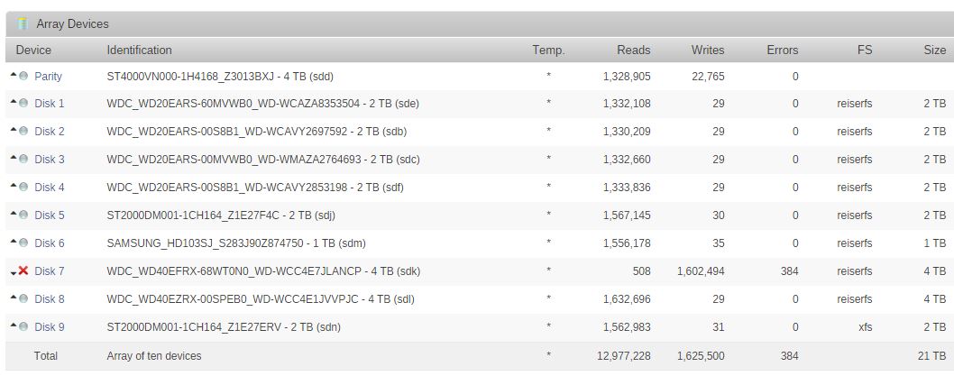

Okay so I thought I had this resolved.  It turns out the original problem was a failing Norco cage.  I figured that out after 3 more drives disappeared from the array.  I moved the drives around and got everything working again.  After realizing my drive didn't actually have an issue I decided to reset the array config after a couple of days of it running fine, to clear the error.  I reset the array, assigned the drives back, and let it build parity.  That all completed fine.  After that was done I decided to check parity.  I woke up the next morning and again Disk 7 is disabled with 384 errors reported on the GUI.  So after letting the new 4TB drive preclear finish I assign it it to Disk 7 and start the rebuild process.  I wake up this morning and Disk 7 is disabled again with 384 errors.  The 4TB drive is in a different slot on a different cable than the 3TB drive.  So I don't understand what's happening here.
I've enclosed a screenshot of the array and the diagnostics file.
Doug
tower-diagnostics-20151013-1849.zip
Any advice here?  I do believe now the 3TB drive has actually failed, and so my decision to reset the array was probably not the right one.  Even though the parity build finished it looks like there are issues.  But at this point how to I get the array back to normal operation?
