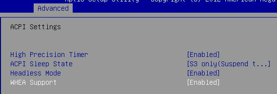

I have Supermicro Server board X10SL7-F with Mellanox 10GbE card: ConnextX-2 Lx (single port SFP). I made sure my SFP card is running latest firmware.

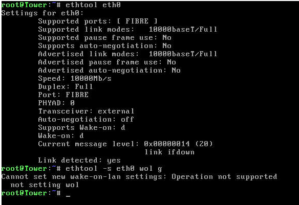

When I do "ethtool eth0", it says wol is disabled.
I get the following output trying to set the wol magic packet message: Cannot set new wake-on-lan settings: Operation not supported
attached are messages from ethtool commands and my BIOS config.
Appreciate help from the community. Thanks in advance.
I am running unRaid 6.1.3 and "ethtool -i eth0" gave the following:
driver: mlx4_en
version: 2.2-1 (Feb 2014)
firmware-version: 2.9.1200
bus-info: 0000:05:00.0
supports-statistics: yes
supports-test: yes
supports-eeprom-access: no
supports-register-dump: no
supports-priv-flags: yes
Can any admin help me check if unRaid is using latest version of the driver? According to ConnectX 2 documentation and firmware release notes, my card should support WOL feature.

I dont think the Connectx2 EN supports WOL. I have them in my unraid server and in a  Win7 box. Both show WOL disabled. I only found mention of WOL support in the dual port card documentation. Maybe they are different. I also tried the 2.9.1000 and 2.9.1200 firmware and no difference. If you find out how to make it work, please post.

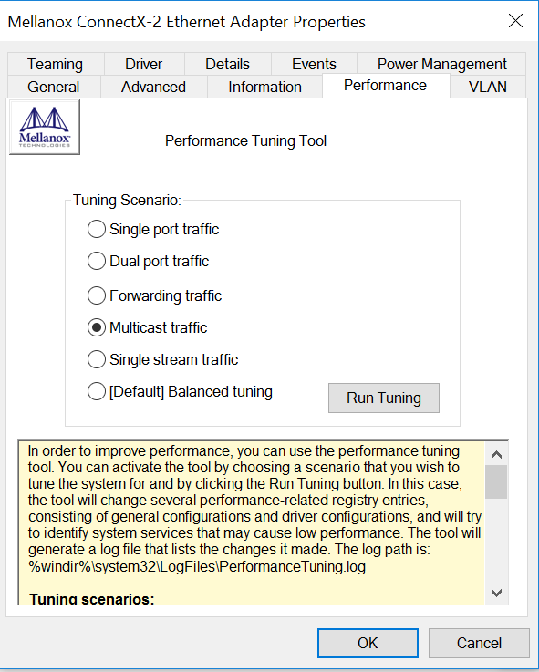

On the W10 machine looking through the adapter properties and i see multiple settings, by default the driver set this to default balanced tuning and i could only get about 110mb/s, I then picked multicast based off the description in the driver it seemed the best option and my speeds raised to 312mb/s max.
Now these transfers are either with a movie of about 5gig or a linux ISO , I have also noticed at times that the speed will drop to around 50mb/s for what ever reason I am not sure,  then other times it will be steady around the 305 - 310mb/s ..... I have seen these speeds either to my OCZ 480gb SSD or to any of the SATA 3 drives.
Is there bottle-neck (I hope not as per i believe i have a pretty fast server) Or is this either a setting in the Unraid or on the W10 driver setting that i am missing?

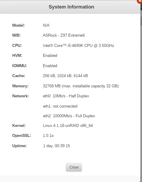

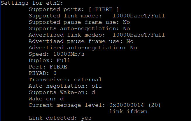

QUESTION - based off the pictures ive attached what would be my interface name for my Mellanox (eth2)  or (FIBRE) this shows up under system devices - 0b:00.0 Ethernet controller: Mellanox Technologies MT26448 [ConnectX EN 10GigE, PCIe 2.0 5GT/s] (rev b0)  sorry a little noobish with linux commands....

Any idea about this ------QUESTION - based off the pictures ive attached what would be my interface name for my Mellanox (eth2)  or (FIBRE) this shows up under system devices - 0b:00.0 Ethernet controller: Mellanox Technologies MT26448 [ConnectX EN 10GigE, PCIe 2.0 5GT/s] (rev b0)  sorry a little noobish with linux commands....
name is eth2. Common jumbo frames setting is 9000. However jumbo frames can be a bugger, you have to make sure everything supports the jumbo frames value you want to use. Some old switches/routers only supported 4k, 6k or 8k. Unless you have some old hardware you probably will see a very small speed boost (if any) using jumbo frames, not worth the bother.
