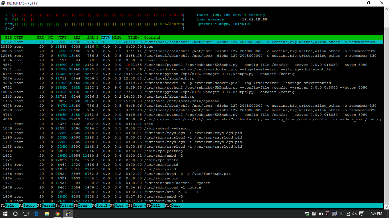

I was deleting some files from my TV Shared Folder... And the operation stopped and windows explorer crashed. Now my shfs is running at 100% and the server load is slowly rising. The load will continue rising until the machine becomes completely unresponsive. I am also unable to reboot the server, it just stalls and will not reboot until the reset/power button is physically pressed.

Its seems that something causes the array to become unwritable, which causes processes to hang and eventually lockup the system?
Any Ideas? This is HUGELY inconvenient.
