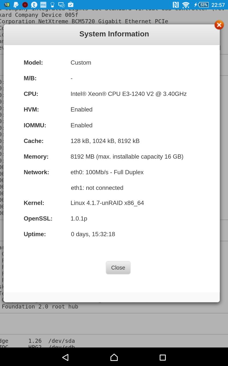

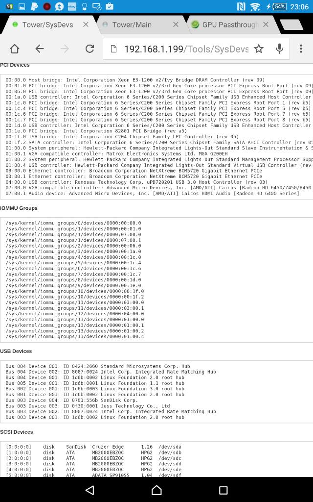

When you click on "info" in the top right of the webgui, what does if say next to IOMMU?
It says enabled.  I have attached some screenshots of systems both withPCIe ACS Override setting on and off. Also the info page in hope you may be able to see a problem there. Many thanks
