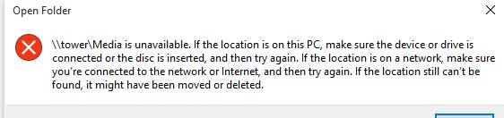

I can access my pictures.  When I try to access the music or media it says they not available.

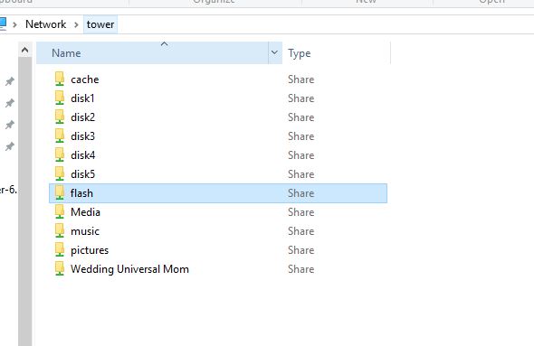

I even try to access the FLASH folder on the  //tower and it is giving the same error now?  I can still look in the pictures folder.
Any ideas ?

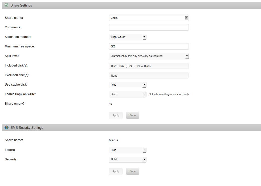

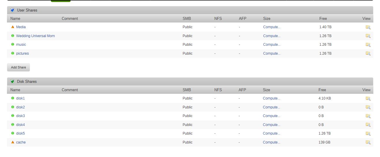

I included some pictures.
I can access the files if I open the individual disk.... but not in the share folder as a whole...if you understand what I am saying ;)

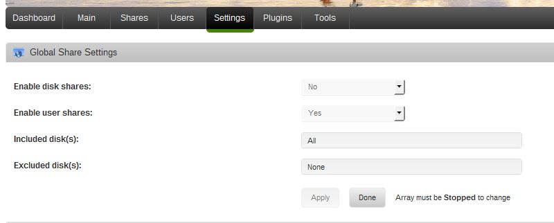

Here is an additional picture..not sure if this has anything to do with it.  I cannot change the values in the drop downs.
