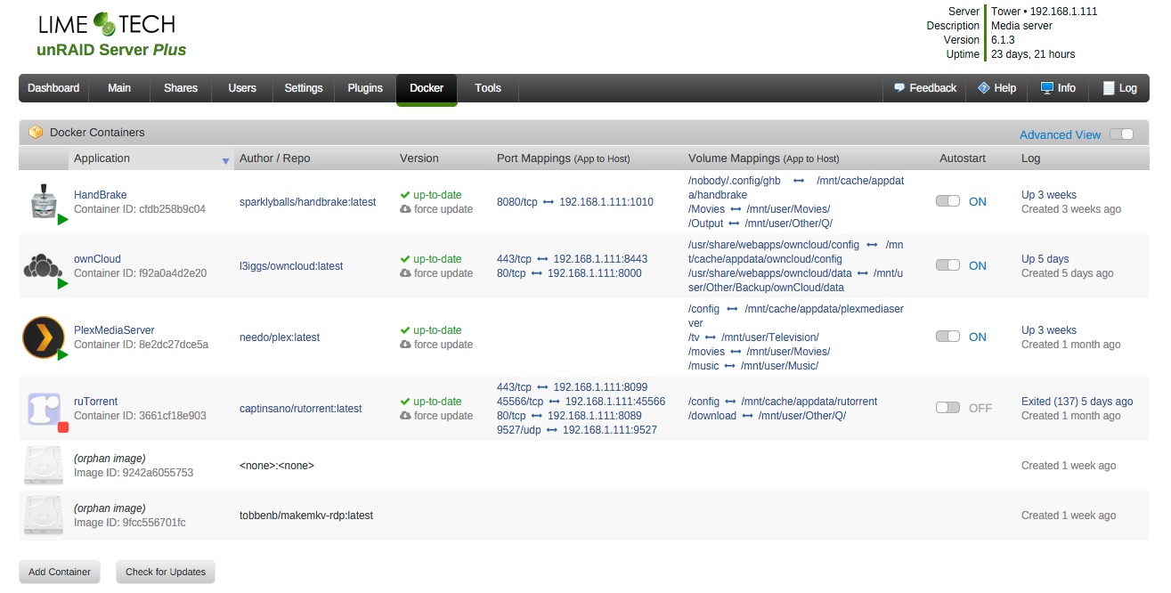

Could you post a screenshot of the docker page with advanced enabled so I can see all the images?
From the error message unraud tries to map /mnt/user/Other/Q still, and not a cache share. You should also consider changing the config mapping to a folder only for makemkv as I see you just mapped appdata/config and I guess you have more than this docker installed?
Attached.

Do you still get an error message if you try to delete the orphan makemkv image? Could you post the error message?
I get this error message:
Command:
root@localhost:# /usr/local/emhttp/plugins/dynamix.docker.manager/scripts/docker rmi 9fcc556701fc
Error response from daemon: No such image: 9fcc556701fc
Error: failed to remove images: [9fcc556701fc]
The command failed.
And if you try to remove the other orphaned image?
Same error but with a different image ID.

Hmmm...
root@Tower:~# docker -d
INFO[0000] [graphdriver] using prior storage driver "btrfs"
INFO[0000] Listening for HTTP on unix (/var/run/docker.sock)
FATA[0000] Error starting daemon: Couldn't create Tag store: EOF
Maybe your docker image is corrupt due to running out of space.
You made me do the math... My docker.img is 10GB. The dockers I have are: 2.114GB, 1.15 GB, 2.132 GB, 1.024 GB, 541.5 MB, 603.9 MB
2114+1150+2132+1024+541.5+603.9 = 7565.4
Should have ~2.5 GB of free space in there still.
It might be time to restart your server also.
You could also try disabling docker and then delete the docker image, enable docker again and recreate your containers by adding the my-templates from the list. Then all your mappings will survive :)
I'll try the reboot first! I'm not opposed to re-creating the Dockers as I don't have very many or complex setups.
Ok, rebooted, no changes. Can't even get Docker to run. How should I proceed now? Delete docker.img from /cache ? Or is there more to it than that...
That is correct. Just delete the docker.img and start docker again.
I also deleted the /appdata folder too just in case.
The command finished successfully!
MakeMKV Docker is up and running! Thanks everyone for your help, this was really bizarre and hopefully doesn't happen again.
