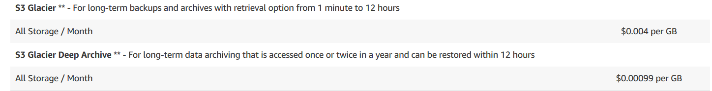

    There is also Glacier Deep Archive. It is slower to retrieve the data if you do actually need to access it, the thawing time is 12-48 hours depending on what you want to pay. It is a fraction of the p

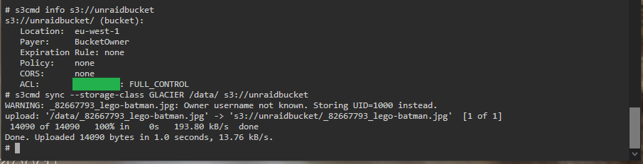

I'm trying out this container, hoping to automate my AWS backups with a lightweight solution! At the moment I use a Windows app called FastGlacier to manually backup files to AWS, but obviously an automated solution would be better.

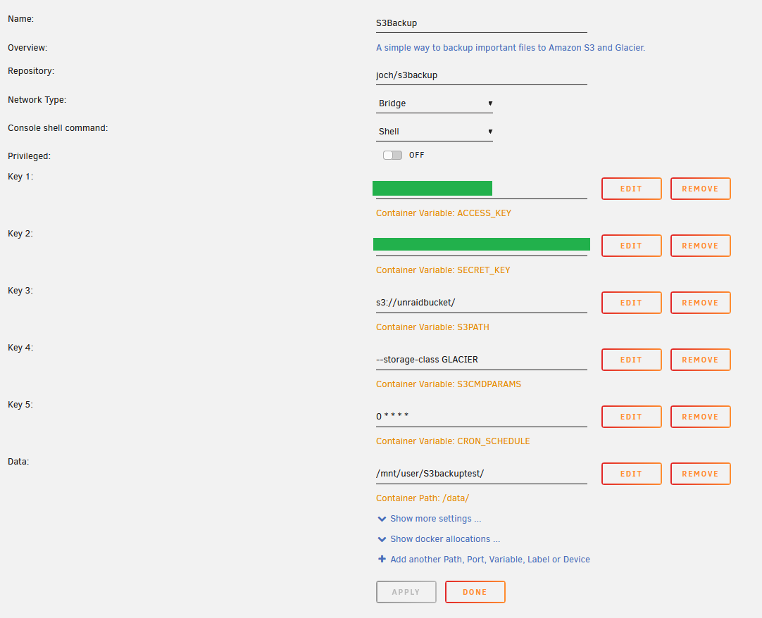

I have installed the container and set my configuration as per the following:
As I want to use Glacier for backup and the lower cost, my storage-class command parameter is set to GLACIER which according to https://awscli.amazonaws.com/v2/documentation/api/latest/reference/s3/sync.html is a supported option.

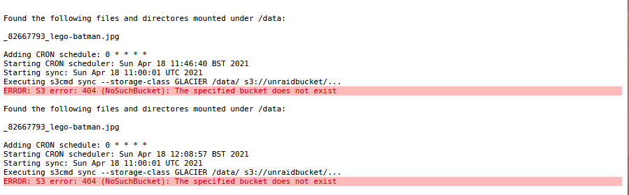

After starting the container and checking the logs, I saw this error saying that the bucket didn't exist:
I don't know if there's a way to create the bucket automatically if it doesn't exist, but in the meantime I consoled into the container and used s3cmd to make a new bucket. I then checked the bucket exists and also verified that I could manually use s3cmd to upload a file from my container's 'data' path:
But I am now seeing a similar issue to that which joeschmoe saw, the job fails due to an existing S3 lockfile:
Based upon joeschmoe's findings, I am assuming this is because s3cmd doesn't like my s3 parameter being set to GLACIER - yet the same option runs fine from the command line when I ran s3cmd sync manually. I can also see that the file uploaded successfully in the bucket using the AWS management console.
I would really like to get this working so would be grateful for any pointers! :) I did try restarting the container several times in case that would help cleanout /tmp but it didn't change the behaviour.
Hi! Try removing the lock file from the Docker container, like this:
docker exec -ti S3Backup rm -f /tmp/s3cmd.lock

Sorry, I meant to add to this thread earlier this morning. I added the --verbose flag to the command parameters and now I am successfully uploading to S3 straight into the Glacier storage class. Maybe the lock file got cleaned up in the interim, maybe it's a co-incidence but it's working!

There is also Glacier Deep Archive. It is slower to retrieve the data if you do actually need to access it, the thawing time is 12-48 hours depending on what you want to pay. It is a fraction of the price to standard Glacier though.
Thanks, found the command line version for it (DEEP_ARCHIVE) after I made those previous posts. But as you say, for big files you don't need quickly it's massively cheaper!
