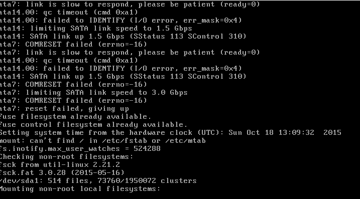

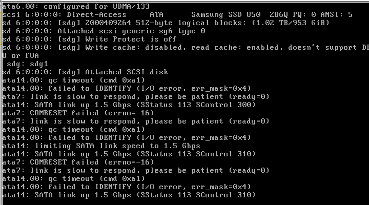

I've connected to the HP Server console and taken these screenshots with the sata link speed errors.

I think that controller has one of the marvell chipsets that can cause problems with virtualization, try do disable it in your bios.
More info here.
Thanks for your reply.
Yes you're right. It's a Marvell chip.
For me it is not the solution to deactivate the VT-d feature.
I'm using the virtualisation of the Unraid server as well.
