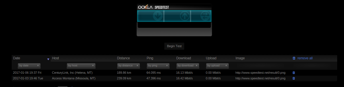

Not sure When but am running 6.3.0-rc6 and the plugin is no longer displaying result image data - just get the background graphic when clicking on a link in the list....
Myk
Myk
I'm on rc6 also. Only thing I noticed is I get a few 0 uploads which results in a blank image. Is there any missing data our 0 value data? Is the link a valid link? Did you run a manual test?
Myk
yes it was a manual test, just ran another manual and I am getting 0 on upload - download is ok, but no images - snip attached

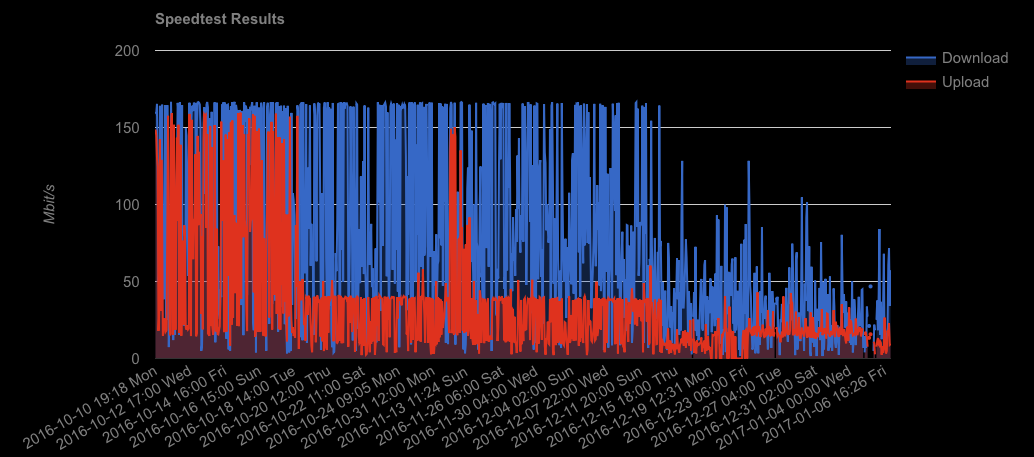

SO I've been testing speed on 2 of my servers for a couple months, results in the beginning were right where I would expect them. Since november though, there seems to be an issue. I have 150u/150d package & on other wired computers in the house I consistently get results I would expect. On my unpaid servers I get substantially less. Looking at the dates, I can't find any correlation between the dates results changed & any subtantial updates to unpaid, or plugins, so I can't seem to figure out what would be causing these results!!
Any Idea's? Has anyone else been tracking thats noticed anything similar?
I updated the scripts. I added support for a different script also. The v1.0.2c is a completely different script. It doesn't give the speedtest image results though.
Run some manual tests with the different versions and see if there's a difference.
Did you upgrade unRAID at all? There was some network problems on previous versions. Also it might indicate a problem with your server's connection or load conditions.

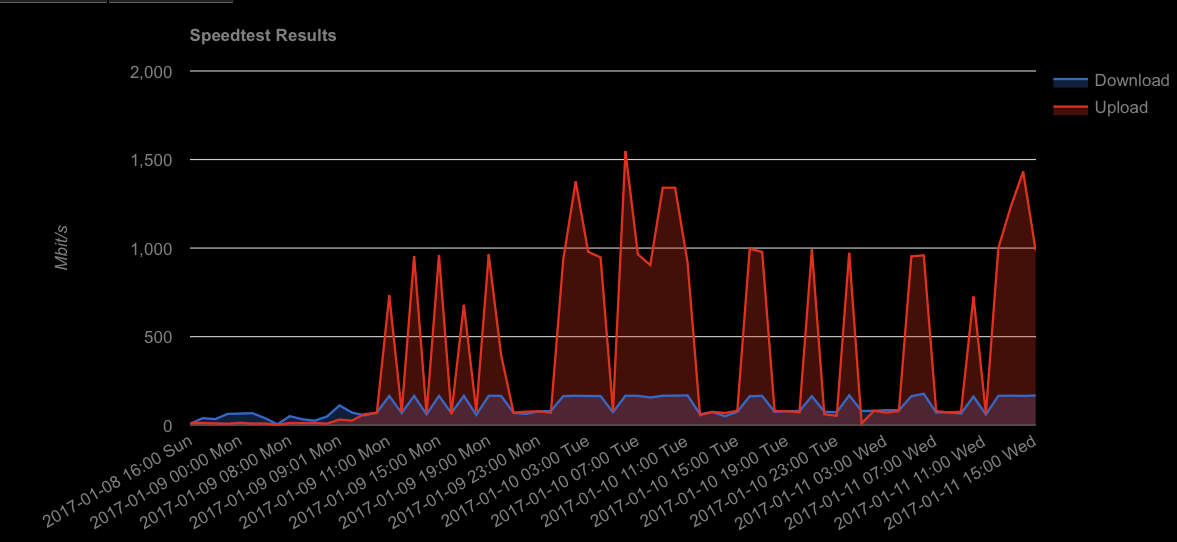

Seem to have another issue with 1.02c, I would be expection 150up/down....
I am 6.3.0-rc6 and I do see the speeds I would expect when i look at my transmission downloads
Yeah that's zpeters' script. I sometimes get upload spikes of 300Mbps but my connection is about 120 down and 6 up. I have reported speed issues on his github also because any version after 1.02c I get half speed.
Did you try the 1.0.1 version? 1.0.1 and below are sivel's script? It's the most consistent for me. The latest commit had pre commit upload data to reduce effects on timing.
i did try 1.0.1, but my results are worse!! at least with 1.0.2c when i wasn't getting the spike's I was seeing what i expected

It sucks the 1.0.2c has those upload spikes though. It really skews the graph with a 1500Mbps upload. Looking at your original history graph the Oct drop in data speeds happen right after the release of 6.3 rc2. Do you know if you were on 6.3 then? The only other thing I can think of is the original scripts are reliant on python. So do you have and other plugin that might overwrite the version of python include with this plugin. The 1.0.2c doesn't require python.
