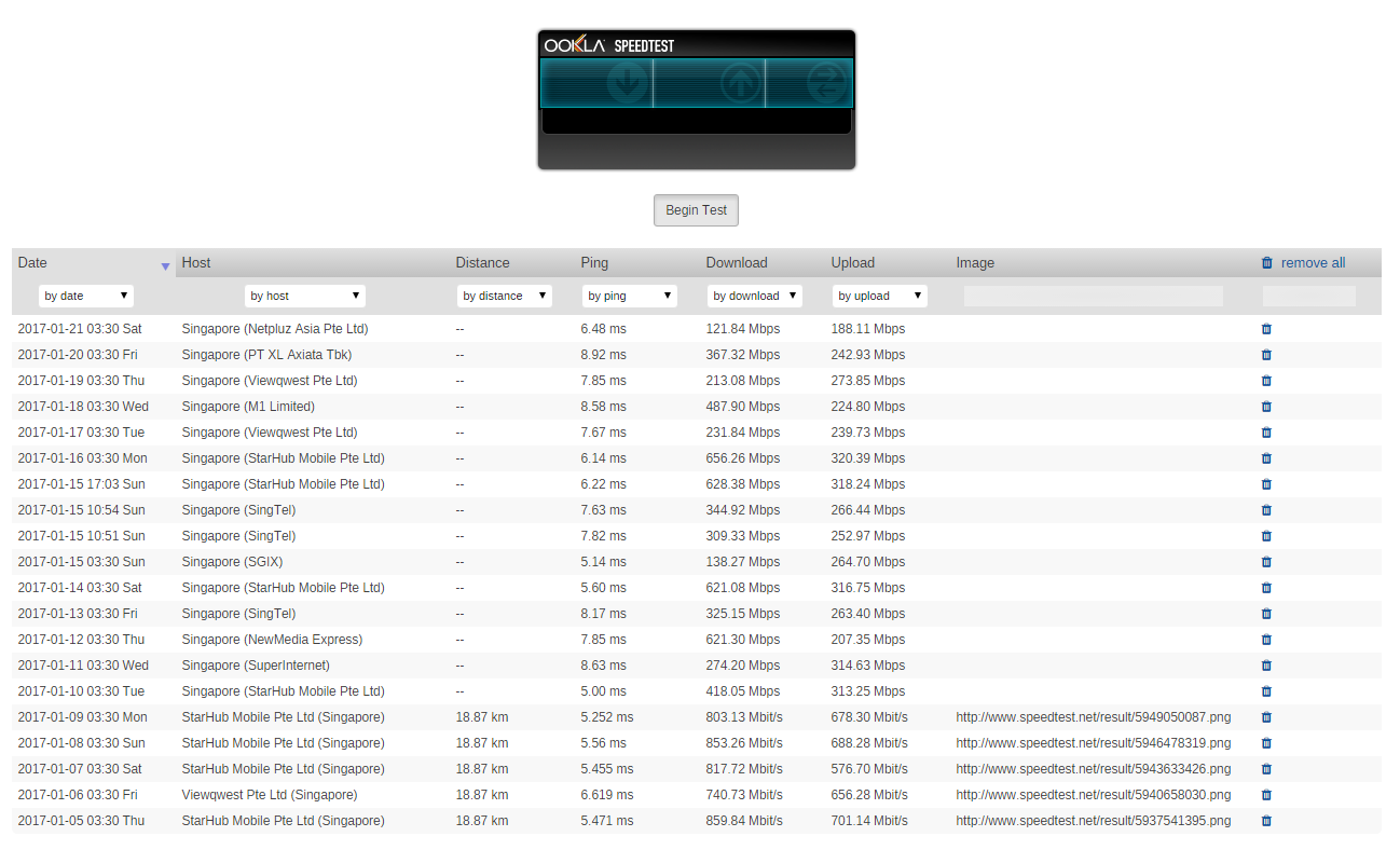

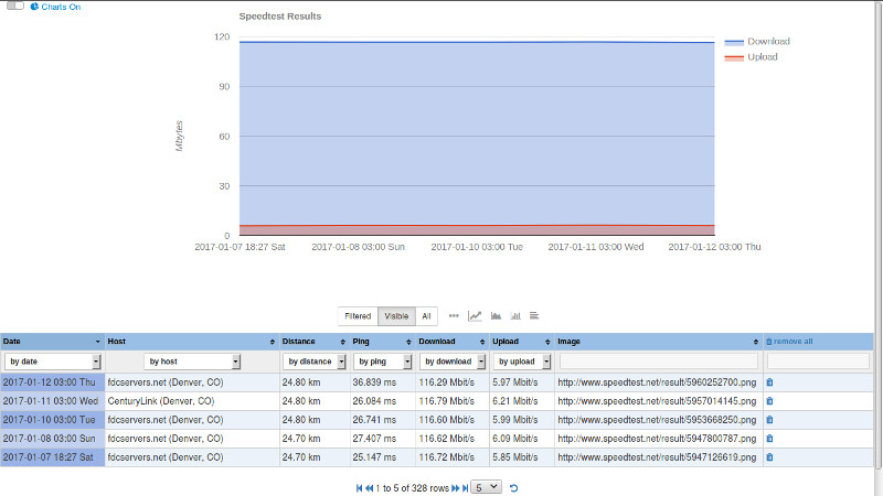

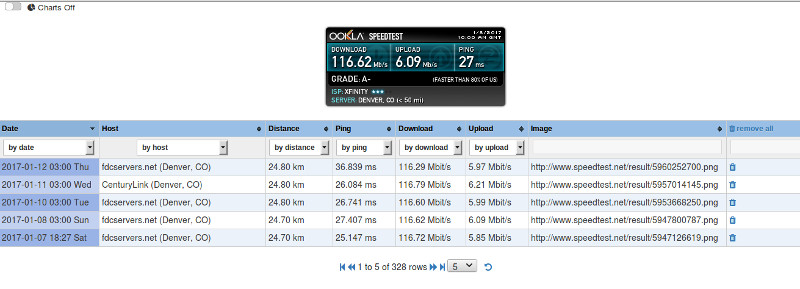

I'm seeing an issue since the latest update, Jan 7th.  Here's the speedtest page.  I haven't moved house, ISP, Router or anything, I think.
I updated the plugin on the 9th so the first run was on the 10th where the data seems missing (and my speeds appear to drop)
EDIT:  Well I found the setting and reverted back to script v.1.0.1 and it's back to the way I had it before.  Considered this closed (unless you feel 1.0.2-c should be working then I'm happy to help debug and try stuff)
The 1.0.2c is a completely different script by a different author with more active development. I should try and make that more apparent on the settings page and/or move it to the bottom of the list. The distance and image are not produce by this script. I was hoping results might be better for some but I see your results are all over the place with it. The 1.0.1 is what I use.
