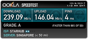

Great Plugin! Thanks. I did look through the topic and did not see a similar post; but I might have overlooked it. I am noticing a significant difference running the plugin on my unraid and running it on a pc on the same network. My pc is reporting closer to what I am expecting than the fastest speed reported by my unraid.
Edited by DJRon
It's in the OP and been discussed here a lot. The speedtest script is really dependent on machine and connection. Especially on faster connections, it doesn't work. But it can be useful if that reading is consistent. It will still show you if there's a problem with your connection.

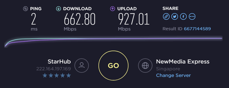

Ah, I was just about to ask a similar thing.  On a Gigabit connection the difference is quite severe as can be seen below.  No worries as long as I now know not to look at this plugin in isolation.
Now, should I call my provider and apologise.....
