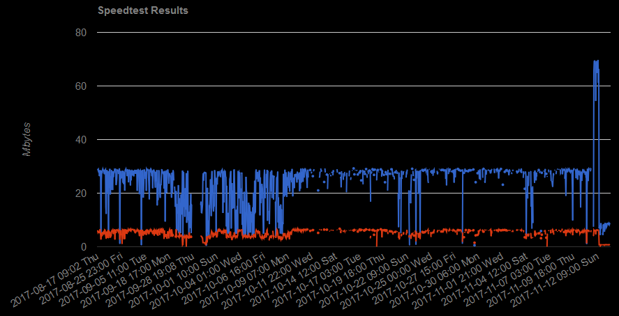

Noticed an interesting artifact...
I went into settings and changed "Save speed values as" from bits to bytes. My graph now shows:
You'll note the nice jump where Comcast/Xfinity took us down unannounced on Sat night for 6 hours, but, when service resumed, my speed approximately doubled! I can give up 6 hours of access for that...
However, on Sunday, I decided to change from bits to bytes and now, my speed looks rather wimpy... Is it possible to save the results in one format (your choice), but display them according the choice I made in settings?
In the meantime, I'm reverting back to bits.
I appreciate this fine tool (yes, you can see just how crappy my connection was in October), and I'll live with it either way. Thanks!
That's a good idea. It's possible since the units are saved in the speedtest.xml for each test. I'll update the plugin to show whatever unit is selected in the settings.  This will not affect the speedtest image just the graph and table.  The image is always in bits.

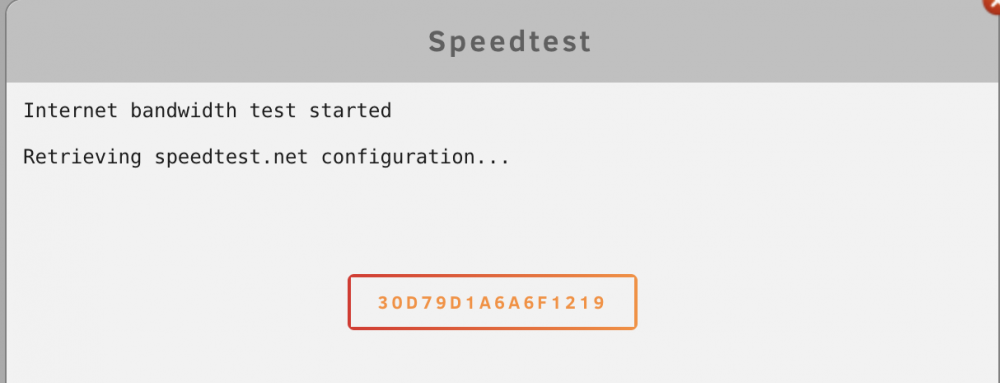

I really like this utility, but unfortunately when I upgraded from 6.35 to 6.4 it stopped working.  It keeps saying that I need Python 2 but of course that was already installed.  I even uninstalled  NerdPack (which contains python 2.7) & then uninstalled Speedtest - restarted my server & reinstalled both.  I still get the below error when I try to run it.  Is Speedtest not compatible with server version 6.4?
This plugin requires python 2 from the NerdPack plugin https://raw.githubusercontent.com/dmacias72/unRAID-NerdPack/master/plugin/NerdPack.plg
NerdPack doesn't inherently install anything. You have to go to Settings/NerdPack and select the packages you wish installed and click apply. They will be installed immediately and on reboot.
I will put that in the pop-up notification also. In the future I plan on allowing plugins to call NerdPack or the repo to install packages like python2. No need to worry about version.
