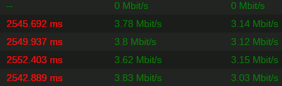

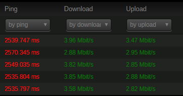

I’m having issues loading the page. It just hangs there. And un-hangs after a long time. Is it because of past histories records?
Edited by CyberMew
Also seems like the speed test repo has not been updated in 4 months. Is this plugin still usable?

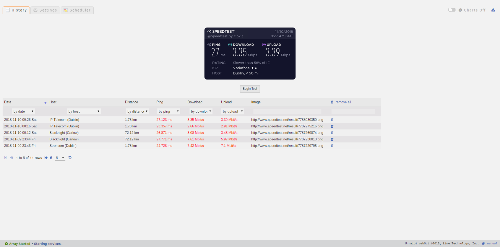

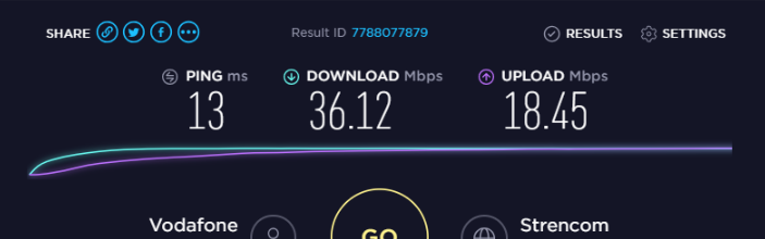

Hi, Im running this plugin and it seems to be runnnig fine and I love the idea of it but the resulta are very bad and I mean very. Im getting somewhere in the 2mbps for download and the same for upload when on my laptop and pc im getting in the 40s and 50s and they are wireless. When I run a docker speedtest I get on the 30s which is better so I don't think it's the cable or port. Any idea what might be happening? Thanks
