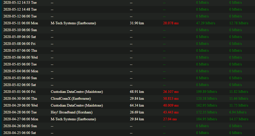

Seems to not run most days for some reason:
If I go to the plugin settings and begin test it says "Internet bandwidth test started" and then does nothing.
However, I can run the sivel/speedtest-cli script manually perfectly fine and it completes in a few moments:
 root@fs # speedtest-cli
Retrieving speedtest.net configuration...
Testing from Virgin Media (x.x.x.x)...
Retrieving speedtest.net server list...
Selecting best server based on ping...
Hosted by Hey! Broadband (Horsham) [28.19 km]: 29.707 ms
Testing download speed................................................................................
Download: 169.30 Mbit/s
Testing upload speed......................................................................................................
Upload: 16.91 Mbit/s
We are just going to have to wait until @dmacias has time to update and finish his plugin.

I think the issue is with python. The githib version requires python3 to be manually specified whereas the plugin version requires python 2.x
