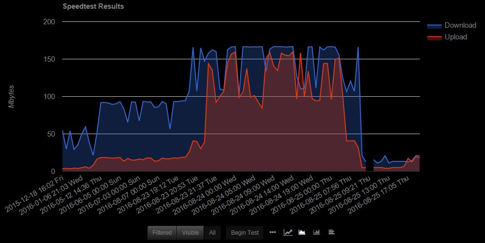

anyone having issues with the speedtest plugin today? this am at around 3 (I have it running every hour) it couldn't get connection with v3.4, changed to beta v1.0 and i get the servers, but my speed is incorrect only about 12m down/up. my computer & all earlier tests are at 160m which is correct
No trouble here. I use 3.4  at 3am once a day. What version unRAID are you on? There are some network issues with some of the 6.2 rc's. I believe it's fix since the last couple unRAID rc releases. I was getting some failed tests but not anymore.
Interesting.  I just checked my history and I have no results for the last few days.  I ran a manual check and saw this error:

I actually don't think it is a bug, I think the server that I was using just isn't available any more.  Unfortunately, I overwrote the "bad" value by choosing a new one from the dropdown, so I can't really tell you what it was before.  This is my current value, which works fine:

I have mine set to Auto. Although it is working again, I dont get the same speed on unraid  that I do on my Desktop....and dont get the speeds I used to get yesterday!
You can see the difference below
Any change? What version unRAID are you using?
seems to be back to normal all of the sudden!
