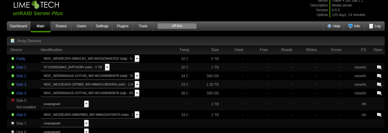

So, ive been away for 4 months for work. Luckily I return in 2 weeks. I tried my best to add redundancy to the server before I left, and it turns out that 1 more backup drive would have been a good option.. or adding a 5 in 3 hot swap cage  >:(
Here's the rundown:
Disk 6: 2 weeks ago I started to get emails about disk 6 having 1 Offline Uncorrectable error. Looked it up and the forum said 1 is ok, more is bad. As of Thursday night, this number is up to 6. Time to move. This is my original parity drive from 6-7 years ago when i started with unraid.. so shes old.
Thurs night i took disk 6 out of my shared folders so the mover would stop adding to it and used MC to move the data over to disk 5. Everything was going great at first (moved about 300 GB successfully), but then I saw the errors adding up on Disk 5 (1536 read errors on the unraid dashboard). Then it said Disk offline, data emulated (or something to that effect).
So, I took the array offline. Its still powered up but i stopped the array. I tried starting the array but now Disk 5 shows nothing and the hard drive isnt selectable.
So... is it possible that a sata cable just happened to come loose after all this time? The drive has been in use for 6 months. Or, is Disk 5 possibly failing as well? I know this is hard to diagnose over the internet. Drive is only 6 months old and has been used successfully since then. 2? preclears before installing. no issues.
What would you do in this situation... Options that I can think of: (NOTE: with disk 5 and Disk 6 BOTH out of the array, I only have 3TB between the other drives, which isnt enough to move both of these drives over to the remaining drives)
-Shut down the server, wait 2 weeks, check it out then. (problem: wifes at home and she wont have access to her tv shows)
-Turn off parity check and and just run with disk 5 offline, move disk 6 data to another disk. (turn off parity check so parity is still valid when i get there so i have more options in case the disk 5 is DOA). hhmmm on second thought this wont work if any changes are made in the meantime
-order a new drive and have wifey install a new drive in the one and only hot swap bay that i have... but it has no fan and would run at 50-53 degrees C until i get home... then just rebuild parity with disk 5 missing and copy over disk 6.
- Offer a south florida unraid member money/beer/etc to check it out or pay an IT guy to go out.
Disk 6 Smart attached. I cant access disk 5 so i dont have the smart report.

UPDATE.. Im back in town new update at bottom
OK, re-seated the cables and Disk 5 was visible. Tried to bring it online but got an Offline error. Power is working as the drive is spinning. I replaced the sata cable, restarted and I can access disk 5 again. See smart report (attached).
However, there is still a red x next to the drive and it says Disabled, data emulated. When I boot the server, I can select the disk from the drop down list. Once I try to start the array, it goes offline. If i stop the array, it shows No Device and its missing from the pull down list until the next restart.
So, i think the drive is working. Smart looks good to me (but I might be wrong). So, does this mean the drive has issues or do i have to do something to force unraid to see the disk again as valid?
Keep in mind that Disk 6 is also throwing errors. A new 5tb drive arrived today, but it still needs to be precleared. But, I dont want to risk Disk 6 dying or Im losing some data.

Disk5 SMART is OK, but unRAID will not actually use that disk until it is rebuilt. See this recent post about how unRAID emulates a drive.
Disk6 SMART shows pending sectors which is bad and might cause an issue rebuilding Disk5, but at this point you don't really have a choice.
Do you have 2 spare disks? It would be best if you could rebuild disk5 to a new disk, and it will be even more important after you get disk5 green again to rebuild disk6 to a new drive, since disk6 needs to be precleared to see if you can resolve the pending sectors.

Unfortunately, another update
So, after being out of town, I had the pleasure of moving and had 8 days to do so.. fun!
Before I left, I ran preclear on the new disk (5tb... 72 hours later), took the old disk 5 out of the array and restored the data. Everything worked great. Since my tower was full, I had the new disk sitting on a flat surface with a fan on it. So, after everything was complete, I decided I needed to take the bad drive out of the computer, and put the new drive in its place. That way, I could deal with formatting and testing the 'bad' drive after the move, and the new drive was secure.
Powered down, replaced the drive. Within 15 mins of restarting... Bam. New disk is Invalid, contents emulated.
Im wondering if my 4 Port Sata card is bad. Thats the only thing that both drives have in common (I replaced the sata cable, and power cable is the same but that seems less likely). Here is the card that Im using and have been for the past 4 years in Unraid (http://www.monoprice.com/product?c_id=104&cp_id=10407&cs_id=1040702&p_id=2667&seq=1&format=2)
Thoughts?
If I should replace it, whats a good and budget suggestion. 4 port minimum. greater than 4 would be great. $100 max if possible
Seeing as i had the exact same issue a few weeks ago, its unlikely that Im having a drive issue. Is there a way for me to get unraid to accept this disk as good again so that I dont have to preclear another drive (72 hours) and rebuild (36 hours). or would this be a bad idea.

Disk6 data may be safe, but what about disk5? One of the reasons it is recommended to deal with pending sectors is because they can cause a rebuild of another drive to fail. If there are any files on any disk that are irreplaceable and you don't have them backed up, do so.
Another diagnostic would let us see the SMART for the new disk. Assuming it is OK you can rebuild onto it again. But you need to address the issue that is causing this if it is not the disk.
new diagnostics here:
https://drive.google.com/file/d/0B1uaV-iMhp2lY2xBODgxbDVpVFU/view?usp=sharing
the current disk 5 is the brand new 5tb. Passed preclear (1 pass, didnt have time for more).
Assuming that it is not the disk (2 identical failures would be very unlikely), Im leaning towards the sata card as it was a cheap card and its 4 years old. And its the only common denominator between the 2. The new disk 5 was working fine (played a dozen movies and other files to test that it was working... all OK) until I moved it and switched it to the sata card (same port) as the old disk 5. The 2 other drives on the sata card are working fine (3rd isnt hooked up).
