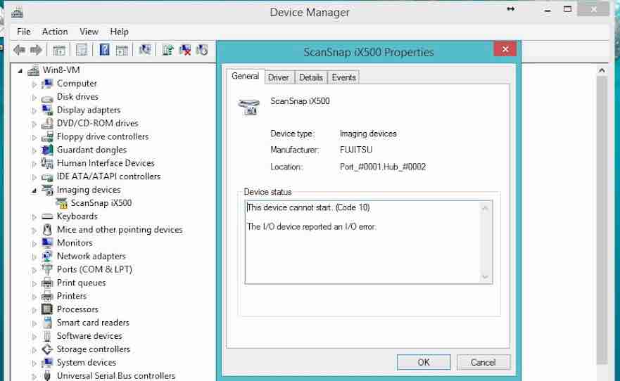

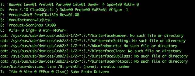

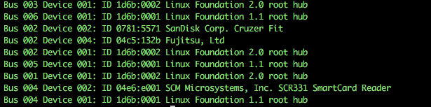

Hi everyone.  I recently purchased a Fujitsu ScanSnap iX500 Document scanner and I would like to pass it through to a Windows 8.1 Professional VM.  I have successfully passed through other USB devices to this VM, including a Smart Card Reader, and USB Hard Drives in the past.  Although Windows does acknowledge the scanner as being a connected USB device, it is unable to start the device.  In Windows Device Manager, the device has a yellow exclamation mark next to it and an error code 10, which states "The I/O device reported an I/O error."  The ScanSnap Manager icon in the system tray also shows the scanner as not being connected.  I have installed the drivers and all of the software for the scanner onto the VM, so I know that it is not a Windows software issue; as  I also installed the same software to my stand-alone Windows 10 desktop and the scanner connects to it with no issue at all.  I would like to connect the scanner to my Windows 8.1 VM because it runs 24/7.  After running some commands on the unRAID server, I noticed that unRAID does not list a driver for the scanner, although it has a driver listed for all other USB devices that are connected, including the usb ports themselves.  Please see the attached screenshots.  Any advice and/or troubleshooting tips to get this scanner working would be greatly appreciated!  Thanks!

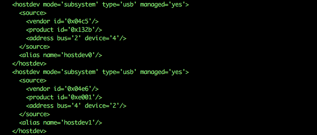

You've used a slightly different addition to your XML than i have... I used this guide: https://lime-technology.com/forum/index.php?topic=38259.0
in my case, my USB controller is listed as this in my 'System Deivces':
60:00.0 USB controller: VIA Technologies, Inc. Device 3483 (rev 01)
so that translates to:
      <driver name='vfio'/>
      <source>
        <address domain='0x0000' bus='0x60' slot='0x00' function='0x0'/>
      </source>
    </hostdev>
Code above will go between <devices> and </devices> tags in your domain XML. There will already be other stuff in there that looks the same, just tag it on at the end before </devices>.
Bear in mind that this is an expansion card and not an integrated motherboard USB controller. if you are passing an onboard controller, you'll need to ensure that your USB boot device isnt in a port on that controller.
Thanks a lot jonp and billington.mark!  jonp your method worked right away!  Now my scanner works perfectly with my Windows 8.1 VM with one little exception.... The SnapScan iX500 goes into a sleep mode after 4 hours of inactivity; or if you close the top cover.  When it goes into sleep mode, the USB disconnects and does not reconnect until i stop and restart the VM.  I am guessing that the only way to disconnect and reconnect a USB device while the VM is running is to pass through the whole controller?  jonp, is there any way to do it with your method?  Thanks again for both of your help.  I went ahead and ordered a USB 3.0 PCIe controller today before I saw jonp's reply, so if I can't do it without passing the whole controller, then I have one on the way.  :D
