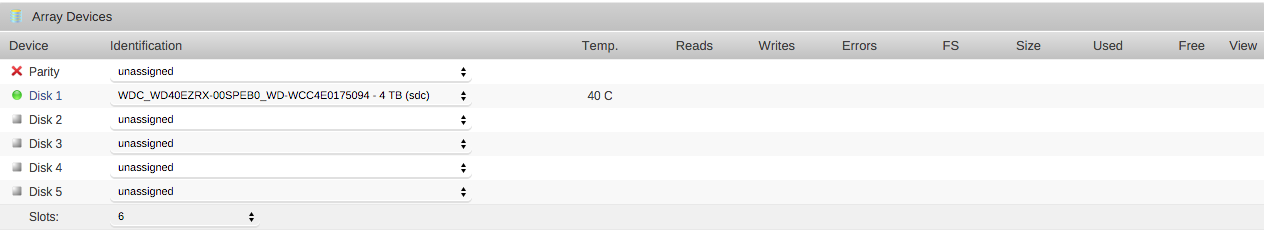

I wanted to play around with Unraid 6 so I installed it to a usb stick an let my nas boot.
Wanted to play around with docker I saw that I needed to start an array.
As I was not sure if Unraid6 supported the ext4 file system (I expected it to so one could transfer data, but it turns out it doesn't) I started the array (with no parity on my drive). I saw that it did not recognise my FS so I stopped the array again and booted in my old os. During the process I did not format the drive
But now the file system seems to be corrupted. Is there any way to fix this?
