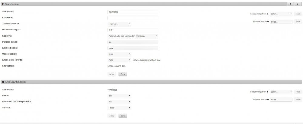

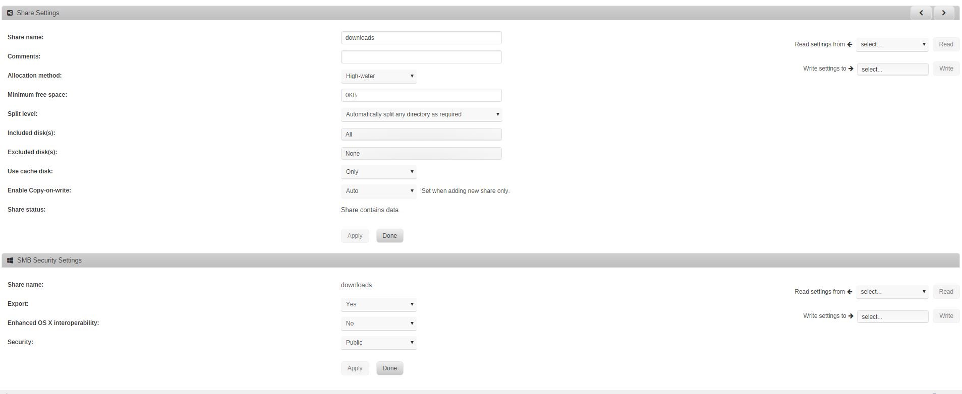

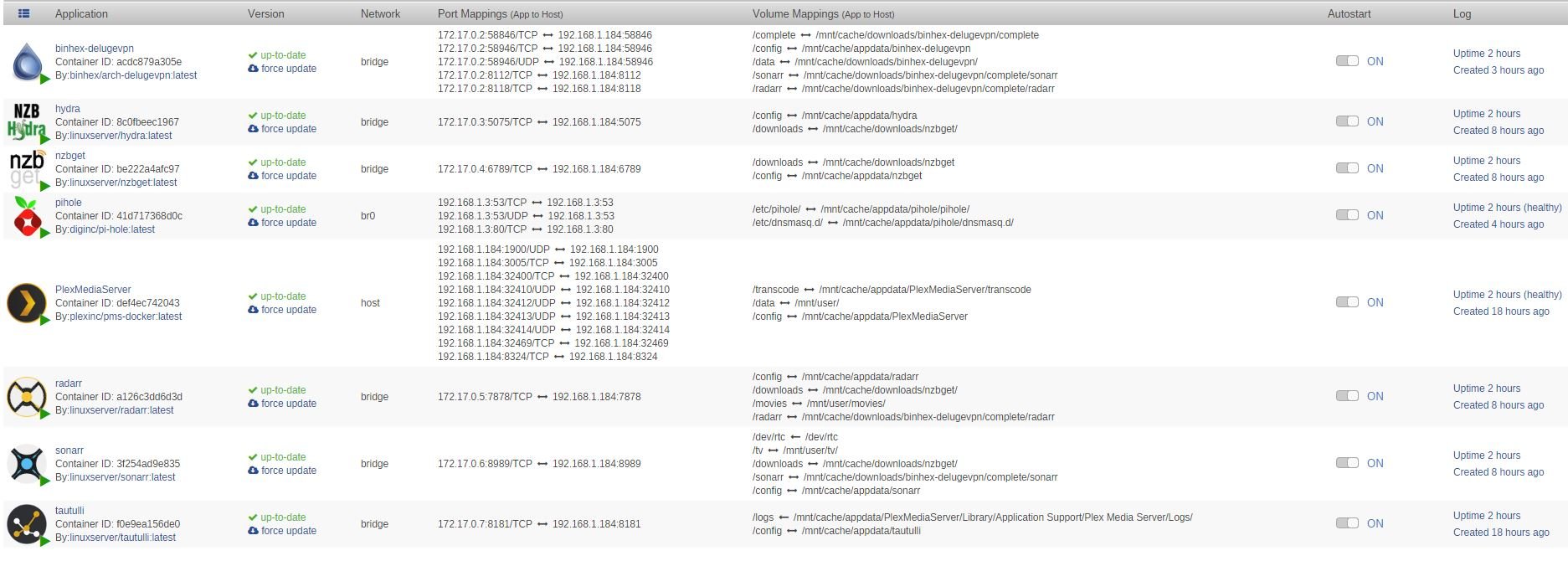

If it's unpacking to the cache drive, you have your volume mapping or share settings wrong. You need to post your docker run command and post a screenshot of the share settings for the shares you use.
Here is my volume mappings and download shares. I'm not quite sure where or what the the docker run command is. Care to elaborate where I can find this information?
I should also say that I did a reinstall on the unRAID OS, wiped the cache drive, and did a fresh install of all containers and plugins and the issue is still persisting.
How to find the docker run command is in my signature. You need to turn those on in your control panel if you don't see them.
But I see that you have set the share to only use the cache drive and also the path in the container template is set to /mnt/cache.
If you want the files to be on the array, you need to change the share to either cache: yes or cache: no.
Set it to yes if you want it to download to the cache first and then moved to the array by the mover.
Set it to no if you want the files downloaded to the array.
