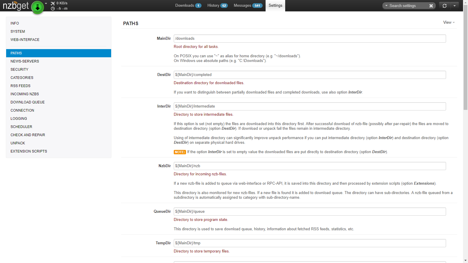

  • LOL - so I finally get everything up and running on Unraid, including nzbget, and I see this at the linuxserver.io git change log:     Surprised this isn't announced here.  Should
  • I was so focused on the download path that I didn't realize it was my category paths that were screwing me up.   Everything is finally working now.   Thanks for the help trurl!  I've been working on t

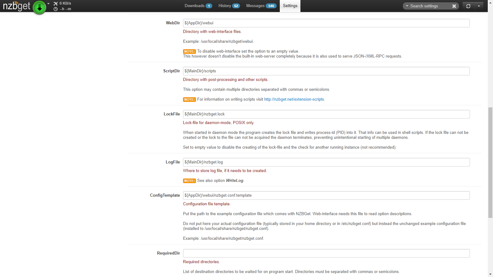

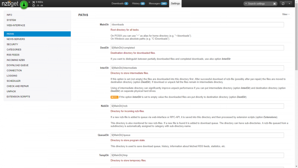

19 hours ago, bigsing said:
Is your issue specific to VideoSort or Post Processing scripts in general? For the container to load the scripts your ScriptDir property (found under Settings > Paths) needs to be set to the location the scripts reside. For example my ScriptDir is set to /config/ppscripts which translates to /mnt/user/appdata/nzbget/ppscripts
it was the first thing I saw, all I want is the file to be named something more like the folder
right now
${MainDir}/scripts
is my script folder,
looks like I got a few other things to sort out
all mt paths are in a share called Downloads. cache drive only. binhex /data points to this directory but sonarr/radarr can't find it.
but it is late and I am tired
Edited by anylettuce

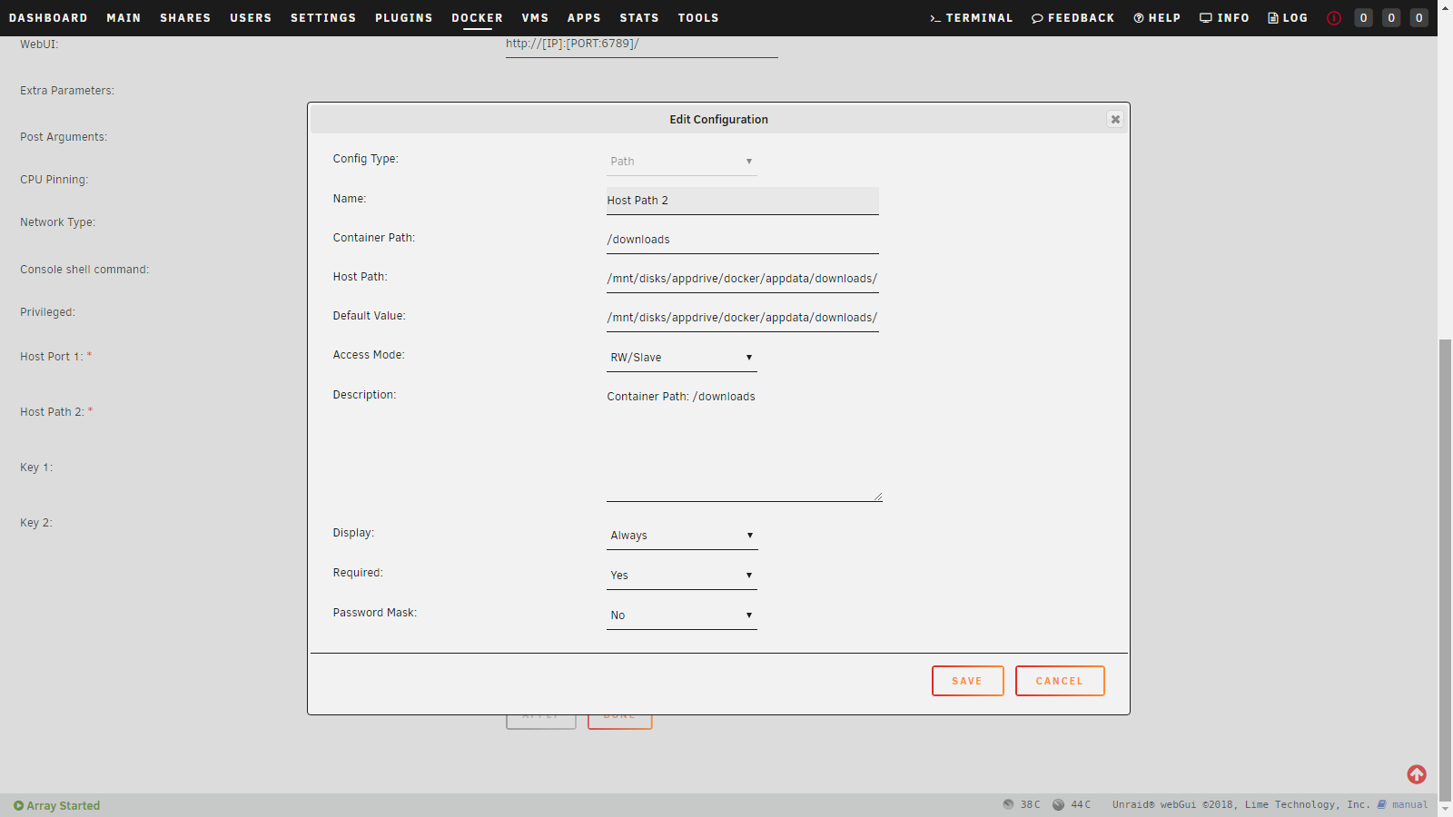

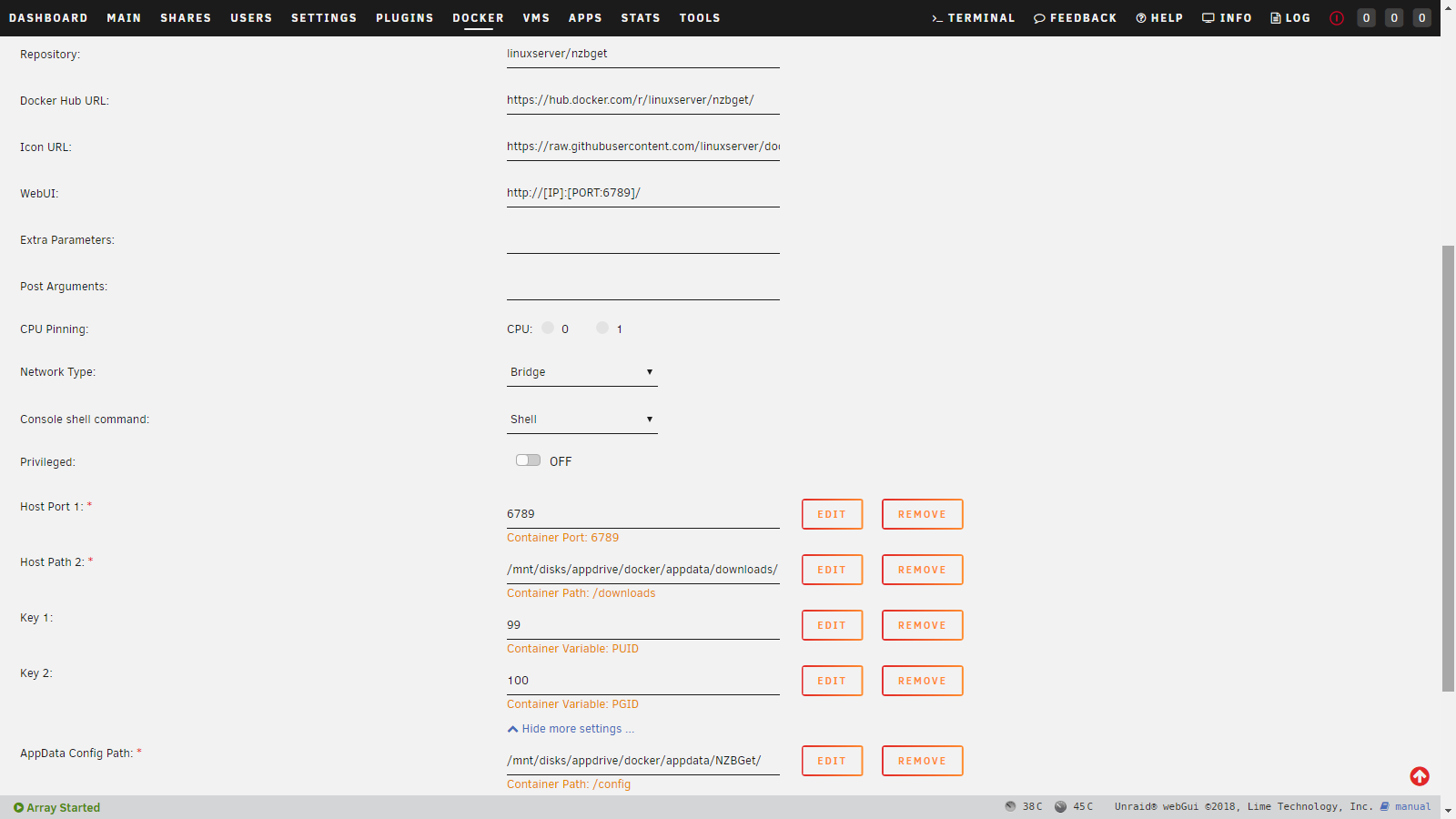

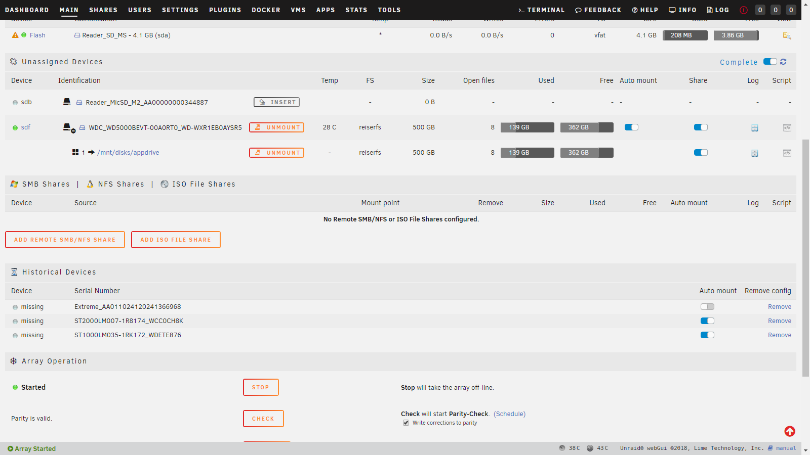

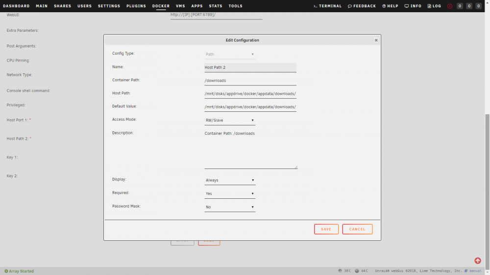

I'm at a loss with NZBGet and need some guidance. I've done quite a bit of searching/reading but can't seem to figure out what my problem is. I found a few things along the way but none of them fixed my issue.
Background: I recently deleted my flash drive by accident and had to re-setup my server. I'm now running 6.6.5. I have all my docker containers installed on a non-array drive. I used to mount this drive via some code in my go script but as part of the rebuild process I switched to the UD plugin. I am reusing the container I had previously so the NZBGet config file has not changed. All that has changed is the docker path mappings because the path has changed since I moved to UD. I did adjust to RW/slave settings for the folders that are on the drive mounted by UD as specified in the UD thread.
My problem: NZBGet is running and I can connect to the webgui. There is a nzb in the queue that says it is downloading but no progress is being made and the download speed is listed as "0 KB/s". I deleted the nzb and then re-added it to the queue and no change. I added a second nzb to the queue and tried to download it and same behavior. I've checked all the container mappings a ton of times and I cannot find anything out of order. I'm not sure where to look. I've included some screenshots of my docker mappings. I had a NZBGet working just fine and all I (think) that I've done is just change the name of the drive and the mounting process for the drive containing the docker image. This leads me to believe I have something messed up in the configuration of the docker container but I could certainly be wrong. Hopefully someone can help me get this sorted out.
Those mappings look like they could work, but we would also need to see how the UD is mounted, and what paths the application itself is using.
UD Mount:
First half of paths:
Second half of paths:
Wait a second, I just read thru the logfile and it's having trouble connecting to the news server. I recently got a new CC and I bet that is the problem. 🤦‍♂️
right now
${MainDir}/scripts
maindir is probably your download folder, just btw... ;)

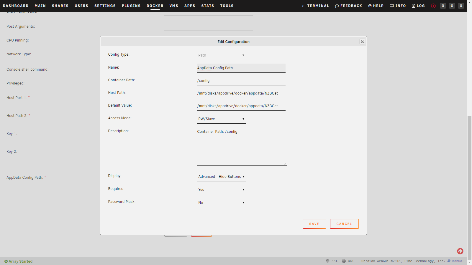

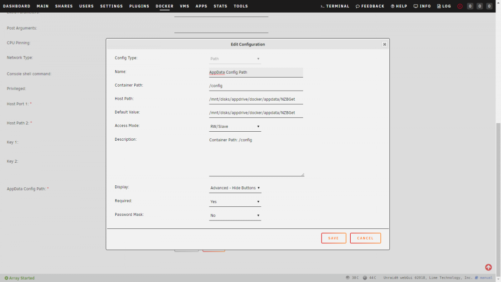

I've had my usenet applications run on a VM for years inside Unraid and it worked fine. I decided this weekend to make it easier by moving all my apps to individual docker images. After pulling down the images, they started up fine for initial configuration. Now that I've got some of them configured - the actual apps (nzbget, hydra2, etc...) don't seem to auto-start when the docker image starts up. Something's preventing the daemon from starting, but i'm not sure what to look at for info.  I'm very new to the docker concept and i can get around Linux structure just fine, but i'm not sure where logs are to diagnose this issue.  Could someone point me in the right direction?
TL;DR - docker image starts fine, the app's daemon does not auto start but will manually start fine. Need location of logs to figure out why daemon isn't starting up - not sure where it is. Let's start with Linuxserver.io\nzbget docker image.
thanks in advance!
Update 2019/01/01 - Resolved
@Squid's FAQ was super helpful. I was setting my docker in /mnt/user/appdata with the default container setup wizard. After blowing all of it away and redoing it to /mnt/cache/appdata - the docker did not have any issue. NZBGet daemon started up just fine after boot and so did Hydra2. Took two days, but i now have my nzbget, hydra2, sonarr, radarr, headphones setup and working great!
Also, FYI to anyone else - I did try mv /mnt/user/appdata/ to /mnt/cache/  - to move everything to the cache drive and that did not resolve the issue with daemon service inside containers auto-starting. I had to re-install all containers and set them up fresh in the /mnt/cache path.
Edited by koshia
Resolution
First link in the Docker FAQ:
That command would have trashed the files in the appdata, as you're mixing user shares and disk shares in the same command (Google unRaid user share copy bug - but it's not a bug)
What squid said. Don't ever try that again!
And please, please, when you have something new to say, don't edit an old post and expect us to find it. If you have something new to add to the thread put it in a new post.

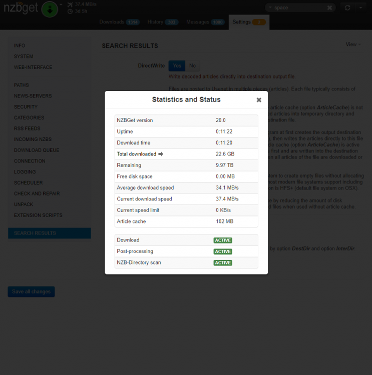

I've just noticed after realising that my downloads weren't pausing when DestDir dropped below my disk space setting ( InterDir is working fine), that my Free disk space in status is showing as 0.00MB.
Is this something I can fix?
Thanks in advance
Thanks in advance
1970053609_FireShotCapture1-131437.4MB_s-NZBGet-http___192_168_10.86_6789_.thumb.png.df91dfd446e276fd6c1827f60442c570.png
How fast is your internet?
