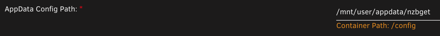

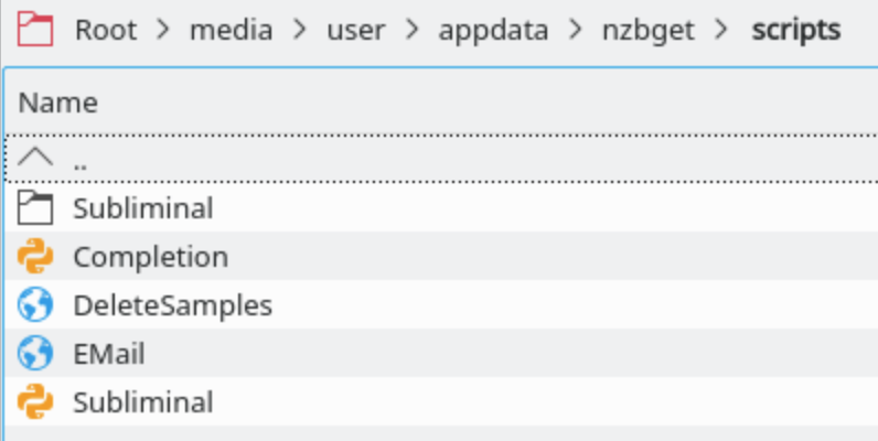

I'm after some help, as my scripts have dropped from nzbget, but I've not knowingly changed anything.
Attached are images showing the settings and hoping someone can point me in the right direction?
The main one I'd like to get working in the email notification.
Many thanks.
Docker config;
nzbget path;
UNRAID path;
Edited by WannabeMKII
Image sorting.
Many thanks.
Can anyone help point me in the right direction?
Thanks.
Thanks.
What's the output of
docker exec -it nzbget ls -la /config/scripts/
Thanks for the response;
root@*****:~# docker exec -it nzbget ls -la /config/scripts/
total 372
drwxr-xr-x  1 abc abc    106 May  4 11:50 .
drwxrwxrwx  1 abc abc     76 Feb 20  2018 ..
-rwxrwxrwx  1 abc abc  78620 Sep  1  2017 Completion.py
-rw-rw-rw-  1 abc abc  65536 Feb 20  2018 DeleteSamples.py
-rw-rwxr--+ 1 abc abc 127037 May  4 11:50 EMail.py
drwxr-xr-x  1 abc abc   4096 Oct 29  2017 Subliminal
-rw-rw-rw-  1 abc abc  90119 Oct 29  2017 Subliminal.py
Well they're there.....
Not sure if they need to be executable though, which they're not, other than Completion.py
docker exec -it nzbget chmod +x /config/scripts/*.py
Edited by CHBMB
Not sure if they need to be executable though, which they're not.
I've just run that too;
root@*****:~# docker exec -it nzbget chmod +x /config/scripts/*.py
chmod: cannot access '/config/scripts/*.py': No such file or directory
What is strange is they've been working fine for a good couple of years, then they just dropped off?
Zip the scripts up and paste them here and I'll have a quick play around.
Perfect, thanks!
Archive.zip
9 minutes ago, CHBMB said:
Change the scripts directory to
/config/scripts
${AppDir} refers to /app/nzbget
Ah ha perfect, that's bought 'subliminal' and 'completion' up, but not 'email' or 'deletesamples?
Why would that happen?
