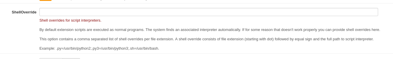

Python is a bit of a mess at the moment, some projects have been updated to python 3, some are still in the midst of migration, the approach we're currently taking is to include python2 and python3 if the underlying project and it's common plugins/scripts.
https://github.com/linuxserver/docker-nzbget/commit/c87dc842020ee2b0f018c6f16cf15b1ff9d41c53
Looks like nzbtomedia has done some backtracking from it's python2 to python3 migration.  New release 5 mins ago adds back python2 compatibility
https://github.com/clinton-hall/nzbToMedia/releases
So, bottom line, container already has python 3 now, and the scripts causing the issue have been reverted to continue to support python 2.
So, if you wish to migrate to python 3 I wonder if the shell override is the way forward to avoid getting down and dirty with the terminal.

Thank you CHBMB!
To summarize, in NZBGet go to: Settings  > Extensions Scripts. In the field labeled ShellOverride enter the following:
.py=/usr/bin/python3
This worked perfectly.
Thank you my friend... and Happy New Year.
H.
Hmmm ...
I tried this and it still not working. I get this error:
nzbToMedia: Could not start /usr/bin/python3: No such file or directory
Did you download the latest version of the Docker...? In unRAID GUI go to Dockers, click Advanced View, and under NZBGet, click "Force Update".
No - it said I was on the latest and I believed it. :)
I just forced the update and working now!
Thanks @CHBMB and @hernandito!

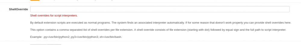

I tried ShellOverride settings and am now getting a different error:
FOMon Jan 06 2020 21:37:28nzbToSickBeard: KeyError: (3, 8)
INFOMon Jan 06 2020 21:37:28nzbToSickBeard: time_left = PYTHON_EOL[(major, minor)] - now
INFOMon Jan 06 2020 21:37:28nzbToSickBeard: File "/config/ppscripts/nzbToMedia/eol.py", line 62, in lifetime
INFOMon Jan 06 2020 21:37:28nzbToSickBeard: days_left = lifetime(version)
INFOMon Jan 06 2020 21:37:28nzbToSickBeard: File "/config/ppscripts/nzbToMedia/eol.py", line 111, in raise_for_status
INFOMon Jan 06 2020 21:37:28nzbToSickBeard: raise_for_status(version, grace_period)
INFOMon Jan 06 2020 21:37:28nzbToSickBeard: File "/config/ppscripts/nzbToMedia/eol.py", line 91, in check
INFOMon Jan 06 2020 21:37:28nzbToSickBeard: eol.check()
Not sure where to go from here
Edit: Got it working, just needed to download the latest nzbtomedia script.
