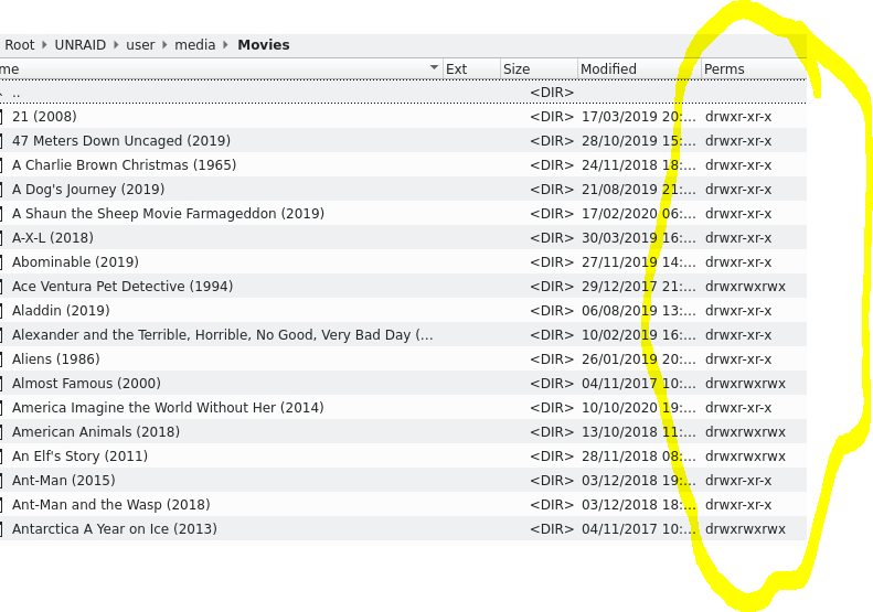

Hello, I need help figuring out a permissions problem. At some point, NZBGet started applying incorrect permissions when downloading content. I only noticed because I was trying update tag data in some audio files from my Windows PC. I double checked unmask settings under security and it set to 000.
So 2 questions:
1 how to fix so future downloads have all permissions in place so that I can edit from my Windows PC.
2. How can I fix current file permissions easily without fixing each file/fold individually?
