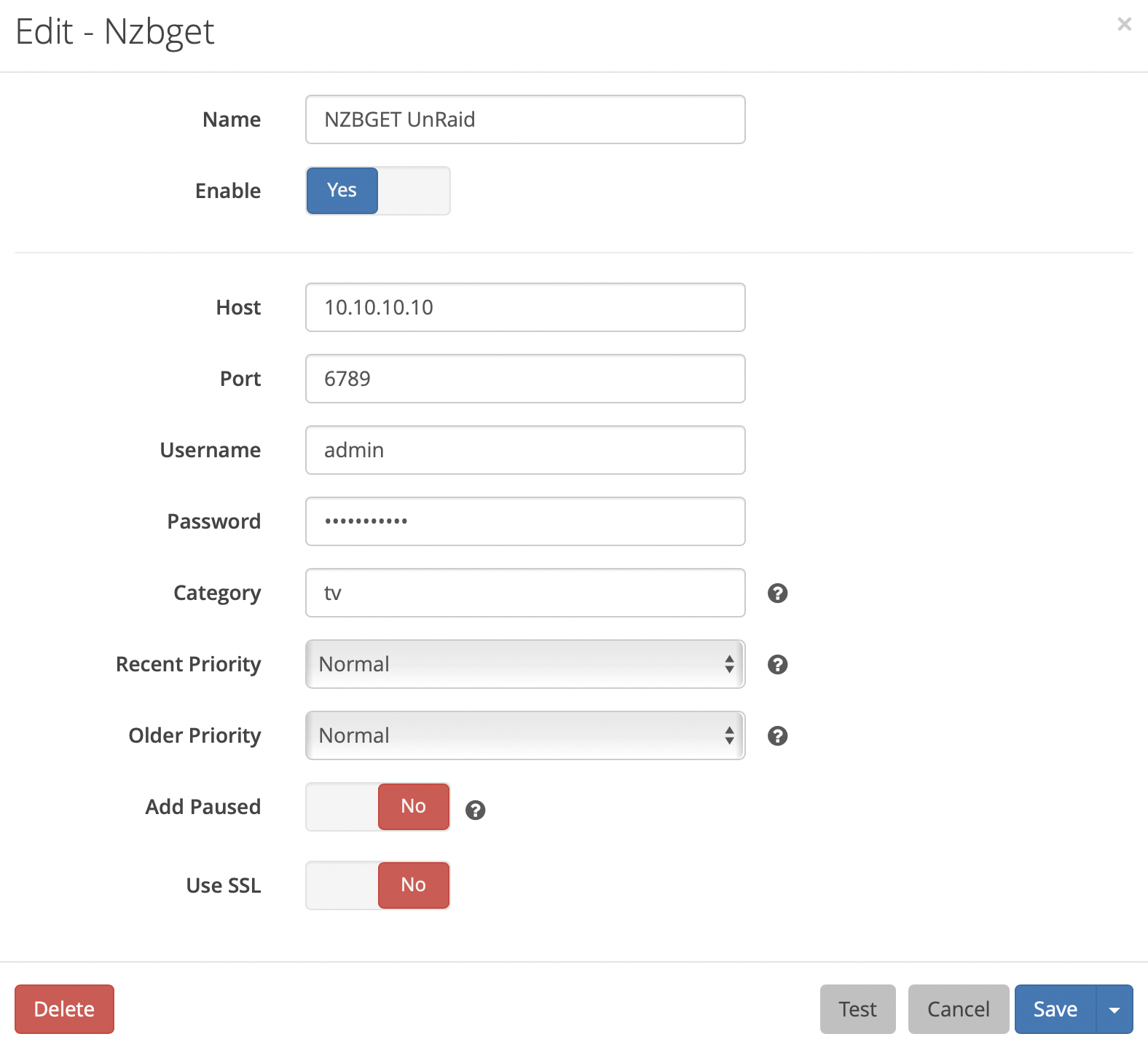

I have run in to a problem, where Sonarr cannot contact Nzbget.
I get the following message:
NzbDrone.Core.Download.Clients.DownloadClientException: Unable to connect to NzbGet. HTTP request failed: [503:ServiceUnavailable] [POST] at [http://10.10.10.10:6789/jsonrpc]
Docker allocations are all correct as well.
I should mention, that nzbget is working and actually is contactable on the IP and portnumber from a browser.
