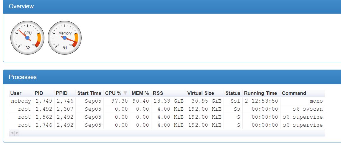

I've been using this Sonarr docker for months and it's worked well.  I've noticed in the past few days that my unRAID box CPU utilization is stuck at around 33% and if I stop the Sonarr docker it goes to zero, then restarting the docker it behaves as normal.  Looking at the log doesn't seem to show anything happening at the time.  Any ideas how I can troubleshoot?
Edit: this happens daily now.
Edit:  I just restarted the docker a few minutes ago and CA confirms that it's using 30% of the CPU
No one else is seeing this?  I've tried reinstalling the docker, both importing the backup and creating it all new from scratch.  Attached is a screenshot from CA showing it at 37% CPU utilization and using 19GB RAM.
Not seeing this behaviour at all on my setup. Log into the webgui for sonarr and check System>Tasks, see if there is anything running?
Never really had the time to fully investigate, but I don't actually believe that sonarr is truly using that amount of memory.  Rather its all the cache, etc that the linux base is using (http://www.linuxatemyram.com/)  and it will get released once something else requires the memory.  But if you truly are worried about it then limit the amount of RAM that sonarr is capable of using (http://lime-technology.com/forum/index.php?topic=40937.msg492112#msg492112)
As far as the CPU usage, I've never really seen sonarr be a pig like that unless its actually scanning or actively searching or what not.  You can also limit its CPU resources (http://lime-technology.com/forum/index.php?topic=40937.msg492111#msg492111) for when something else requires the cpu time.
The key question is sonarr actually working for you?
Yeah, it does seem to be working.  That said it's worked fine for months with zero issues, but now in the past few weeks this CPU and RAM thing has started.  I could limit the Docker's access to CPU and RAM per your suggestion, but would prefer to find the underlying cause.
