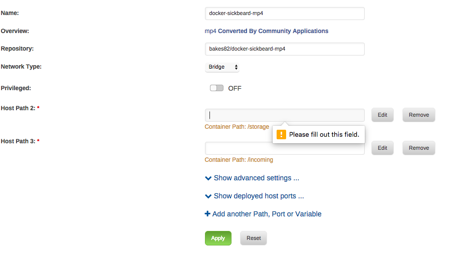

I'm using https://hub.docker.com/r/bakes82/docker-sickbeard-mp4/ .
When installing the docker, I tried to leave the directories blank but the interface wouldn't let me.

I found the info on the github page you linked earlier....
You need to fill in at least the /incoming path. How are you going to get the container to process your files otherwise?
If you only want the /incoming volume, just remove the /storage one.

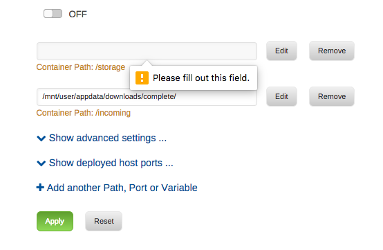

Sorry I was looking on the docker hub page, just went back to the github page and saw what you were referring to.
I tried filling in the /incoming path and leaving the storage path blank but it wouldn't let me apply the setting:
index.php?action=dlattach;topic=43601.0;attach=38172;image
Should I use some kinda notation in the /storage path to indicate current director since the page won't let me leave it blank?
I tried removing the /storage path completely but I don't think that worked. I still have an MKV file.
