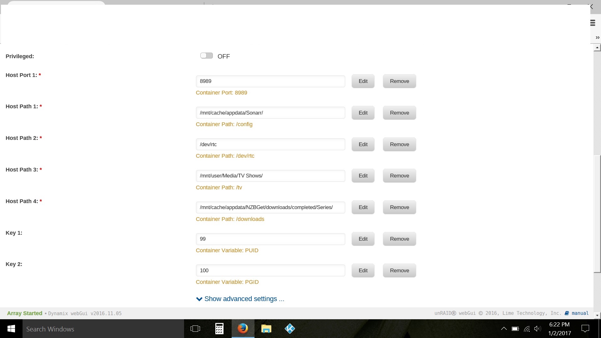

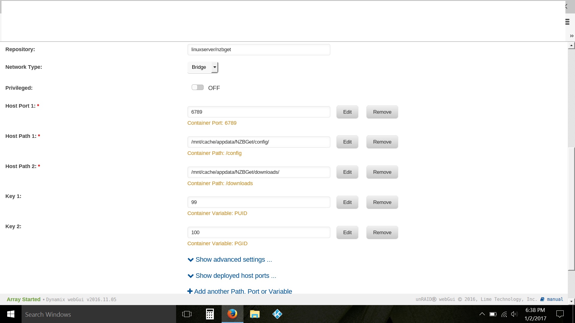

Hey everyone. First time poster so be gentle plz.
My mate recently convinced me to change over my Plex server to unRAID from Windows, it's been great so far except for one little snag that has really thrown a spanner in the works.
He's been using unRAID for years now and he can't figure out what the issue is so there's little to no help for a newbie like myself.
Basically Sonarr and NZBGet are all working great, except when a download is completed, Sonarr is unable to move it to my TV Shows folder.
In the logs I get the error 'Import failed, path does not exist or is not accessible by Sonarr:'
We've checked all the paths and they are fine. He's also checked the permissions using putty and that didn't work either. I've also tried the permissions from within Sonarr, but to no avail.
I'm able to provide logs, screenshots, etc if needed.
Thanks!
Logs and screenshots of both Sonarr and NZBget would be useful.  Better than screenshots would be the docker run command.  See my sig.
