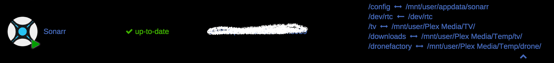

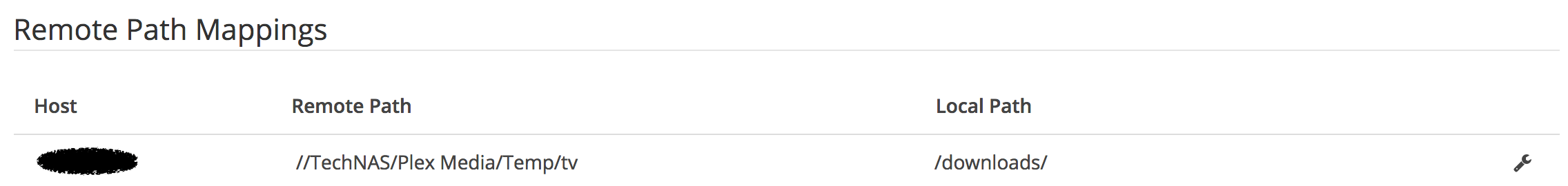

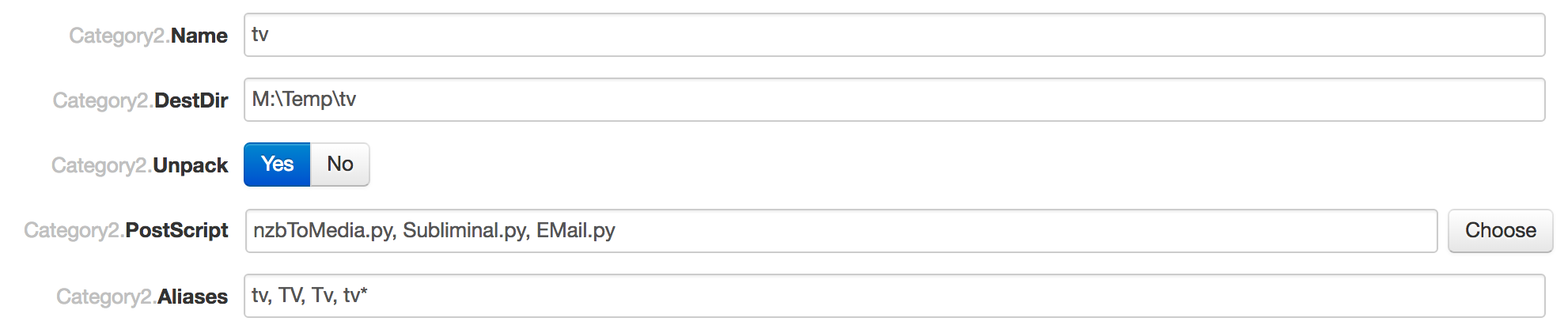

I'm having a similar issue with post processing, but my install is currently slightly different, as I run Sonarr on unraid and NZBget on my Windows 7 machine (at the moment) and use nzbtomedia.
So, nzbget downloads to a local drive and folder on Win 7, it then unpacks the file and moves it to unraid on a shared folder. nzbtomedia then checks the files (video check etc) and passes the instruction to Sonarr to rename and this is the step that goes wrong, hence being here.
The Sonarr log reports "not a valid *nix path, paths must start with a /". I've spend hours trying to work this out and trying different paths, but can't get it to work, so here's a few screenshots that I hope will help. Ignore dronefactory, I'm not using it.
Can anymore make sense of what's going on and here I assume I'm going wrong?
Thanks!

The hint is in the error message from sonarr. One of your paths is missing the / in the start. So check all your folder paths in the sonarr settings.
Trust me, unless I'm missing the obvious, I've checked and double checked all the paths. I'm guessing you know where the problem is from the screenshots? Any chance of a more obvious clue?  :P
Its not in the screenshot as I see. I don't know sonarr at all, so can't point you to any direction there, but since the message is from the sonarr container, it must be a path in sonarr that is wrong.
If I understand this correctly, nzbtomedia performs the post processing on the win7 box (and runs on it)? And then moves the file(s) to unRaid
And it sounds like nzbtomedia then tells sonarr where the files are?
I don't do this, but it seems to me that it's not going to work because nzbtomedia is going to pass a path such as M:\newlydownloadedfiles\whatever\file.mkv to sonarr
Sonarr has zero concept of drive letters (and neither does linux for that matter)
In a mix situation like this, your probably better off using drone factory until you get everything onto the same box.
Either that, or you've got sonarr set up incorrectly.  It looks to me that whenever sonarr sees a remote path passed to it that matches (\\TECH_NAS\....) it substitutes /downloads.  Is the path being sent to sonarr matching that?  Or is the path something like M:\newlydownloadedfiles\....
Sonarr logs would probably help out here.  But then again, I don't see the need to run any extra post processing, nor do I (or have ever) run the programs on two distinct systems, so I might be blowing smoke out my ass  ;)
It's such an unusual setup that you're probably going to have to figure it out by yourself.  My guess is as windows uses \ and Linux uses / there's a problem at some point in that chain.
I'm going to have to revisit this tomorrow, as I tried using 'Completed download handling' and nothing appears to happen. So for now, I'm just using 'Drone Factory' to scan the directory.
Thanks for the help guys, appreciated, but I may well be back to try to work this out, as I'm like a dog with a bone!  :o

I just started using Unraid and let me say im so happy i found this software. But Im having an issue. Right now im running both rutorrnt and Deluge. For some reason Sonarr wont connect to Rutorrent. Can someone help me out with the configuration? Both are running in dockers. Here are the ports for rutorrent.
51413/tcp  192.168.1.90:51413
6881/udp  192.168.1.90:6881
80/tcp  192.168.1.90:81
See my sig for how to post more info.
