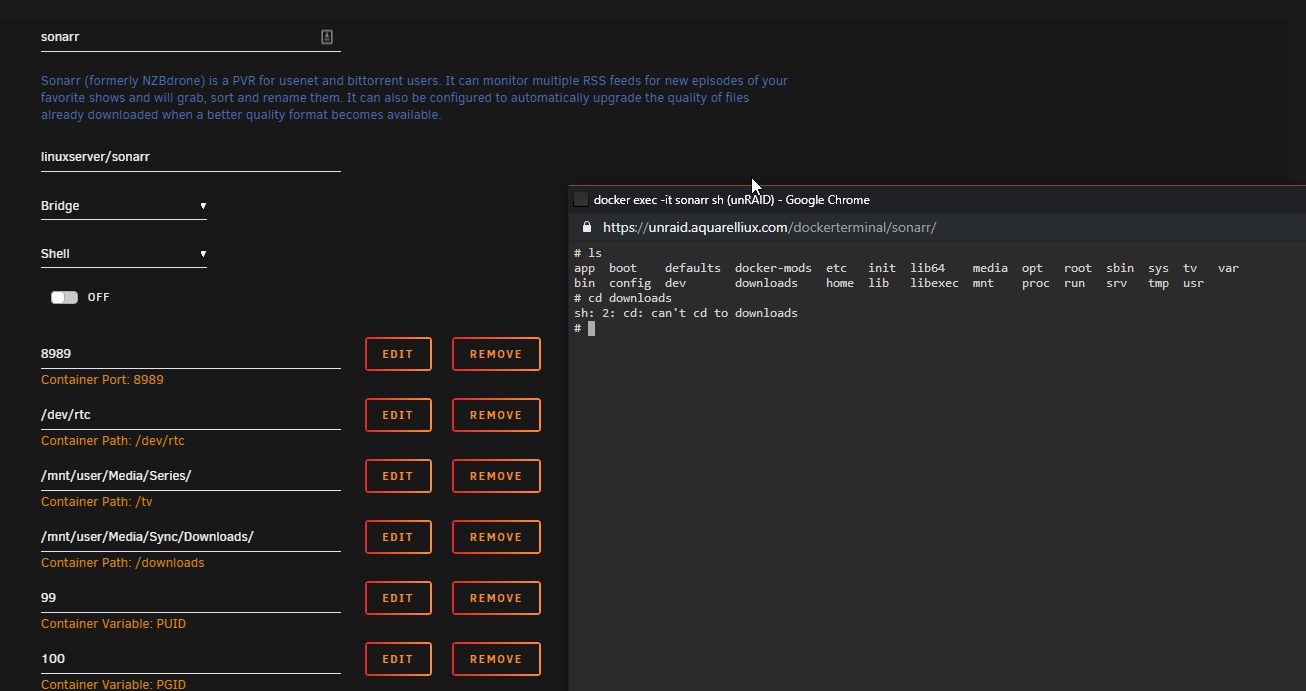

Hello Sonarr docker
I have an issue with sonarr and my unraid server. Sometimes it looses its mappings to the unraid shares. Here is an example:
It only happens to the Downloads folder and I have not found any other solution than to force rebuild the docker. Same thing happens to radarr at the same time. Anyone with the same problem?
